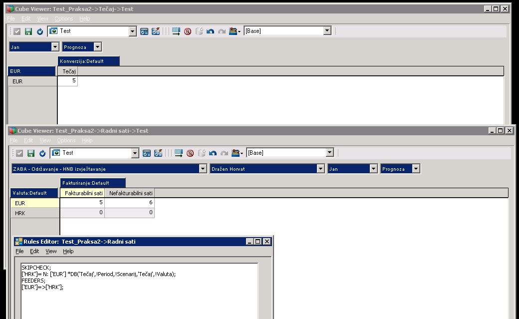

I wrote your roule but unfortunatelly it doesn't work. Maybe piture can help.
Cube 1 is Radni sati
Cube 2 is Tečaj
Cube 2 is Tečaj
- SLika 1.jpg (119.25 KiB) Viewed 11094 times

Re: Problem with calculation
No, sorry, it's blatantly obvious from your screenshot that you did not use the code I provided. You changed it and that's why it's not working.

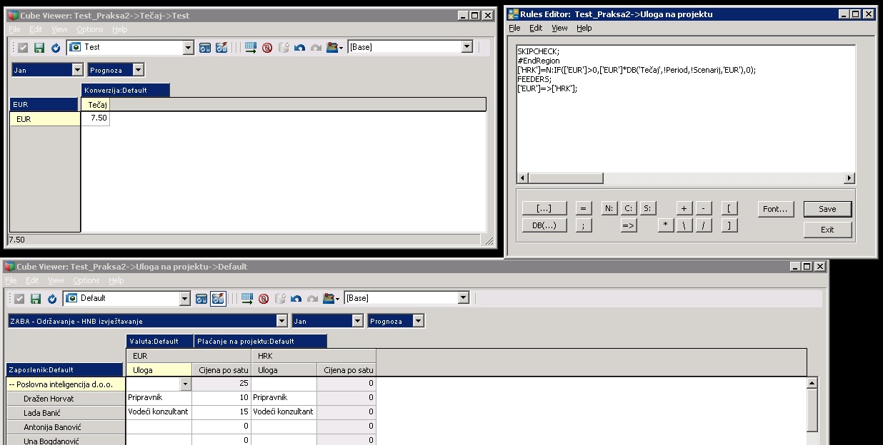

Hi! I really don't know why my rule formula doesn't work. I've read rules guide, but it doesn't help. Please anyone can help me to get right calculation.
If you look at the picture I need to get for example this value with rule
Cube named Uloga na projektu: HRK Cijena po satu=EUR Cijena po satu* EUR from Cube named Tečaj
So if we see Dražen horvat the value is 10*7,5=75 HRK I get nothing in HRK field?
- Slikovito.jpg (158.85 KiB) Viewed 11025 times

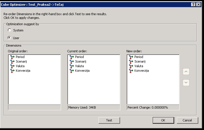

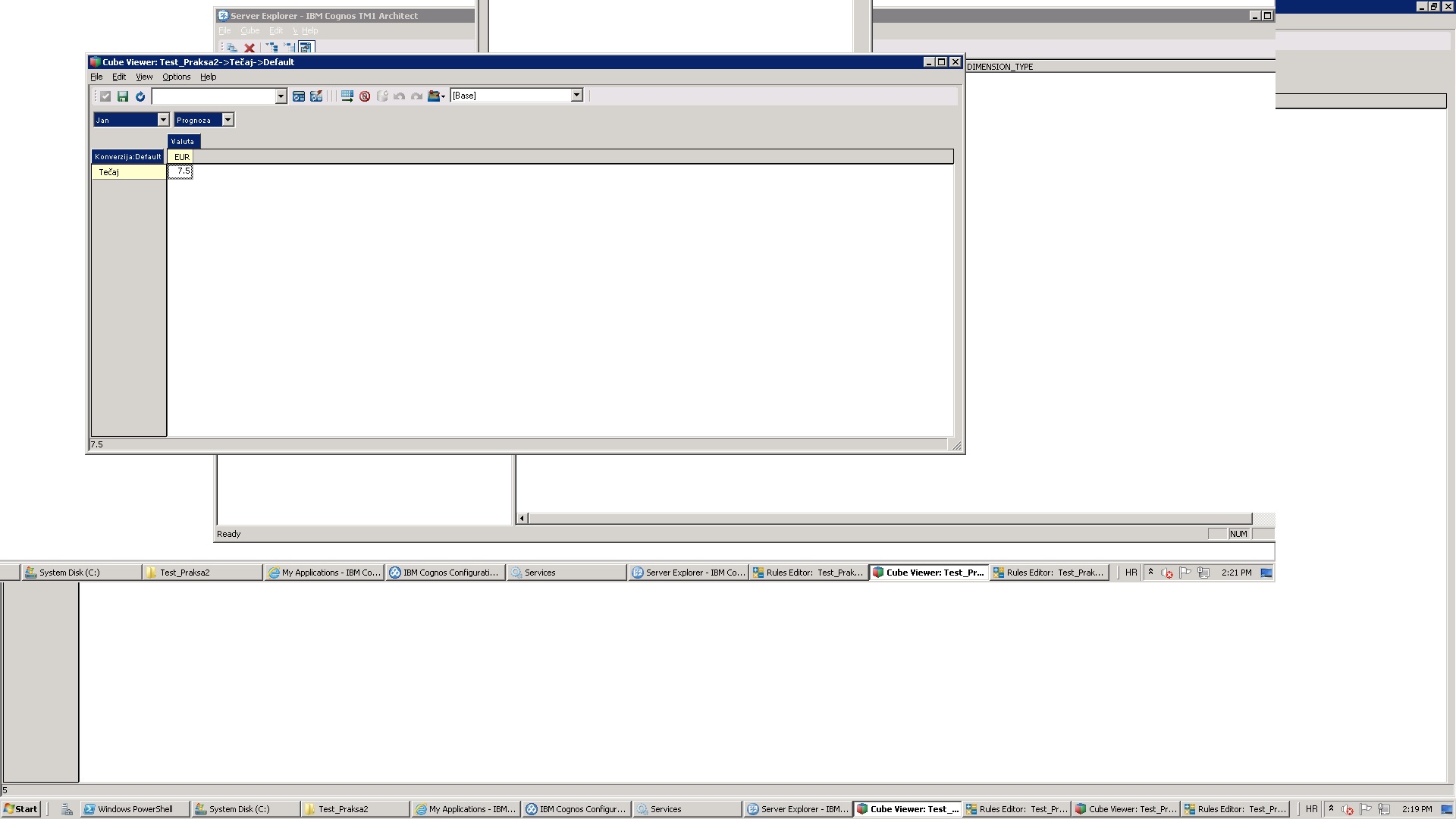

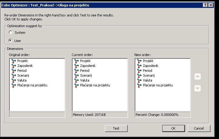

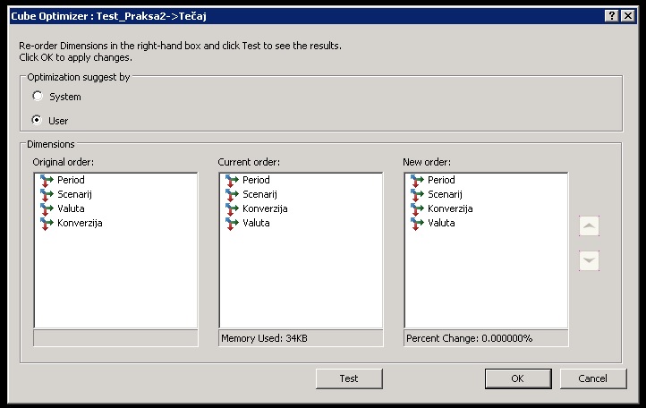

Here is the order of dimensions in both cubes:
- Uloga na projektu order.jpg (74.37 KiB) Viewed 11024 times
- Tečaj order dimension.jpg (64.34 KiB) Viewed 11024 times

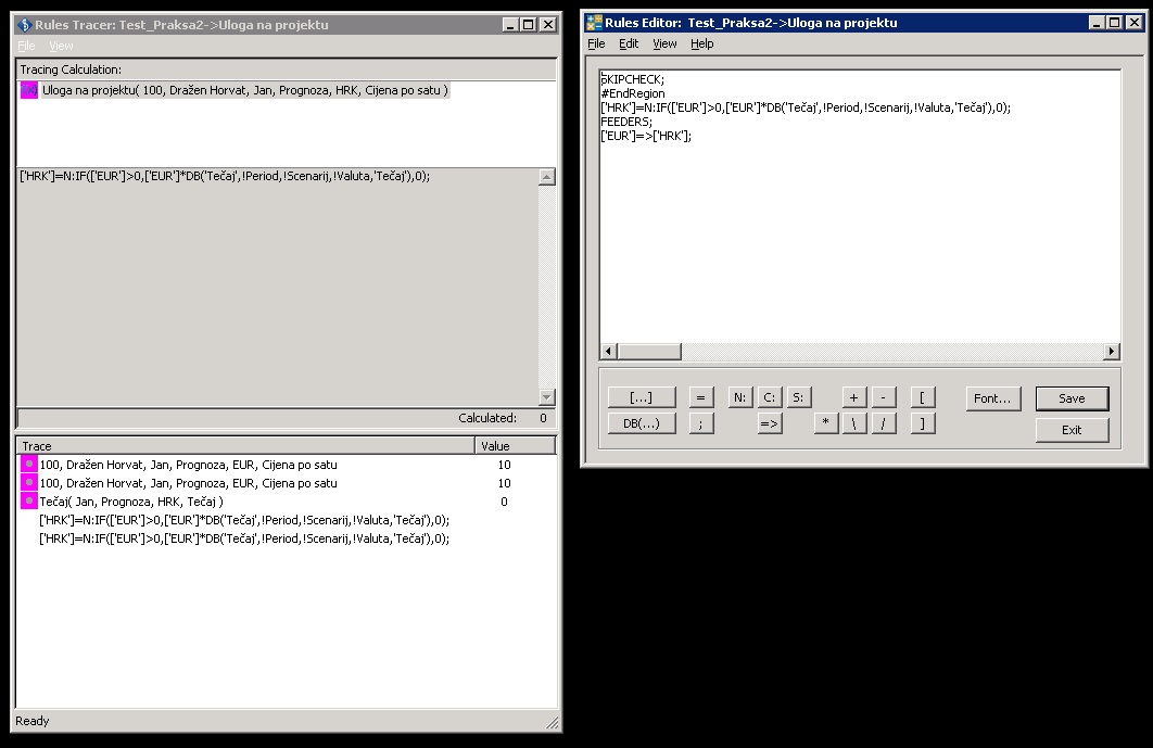

When I click trace calculation in Cube Uloga na projektu cube in intersection Dražen Horvat and HRK cijena po satu nothing happens
- Posts: 1833
Your trace calc issue seems surprising. It does sometimes open a pop up window in a small box that you need to expand to a useable size.
Just noticed that your most recent screenshot only has 3 dimensions referenced in the "Tecaj" cube even though the cube has 4 dimensions and your earlier posts included 4 dimensions. Why have you gone back to removing one??
Have a look at re-ordering the statement (the one with all 4 dimensions referenced) to mimic the original order of dimensions instead of the re-ordered one.

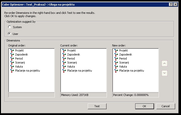

I've adjusted new order with original one if you had meant that? I' also found pop up window to trace calculation. But unfortunally the problem is same:
- sve.jpg (115.96 KiB) Viewed 11016 times
- novi poredak 2.jpg (62.51 KiB) Viewed 11016 times
- novi poredak 1.jpg (73.6 KiB) Viewed 11016 times
Please check your rule trace screen, 3rd item, it is referencing to HRK, which is returning 0. While your rule is structured correctly, are the element references correct?

- Posts: 1833
As has now been mentioned quite a few times you need to reference 'EUR' in the DB statement; if you don't specify it will pull the same element on the left hand side.
