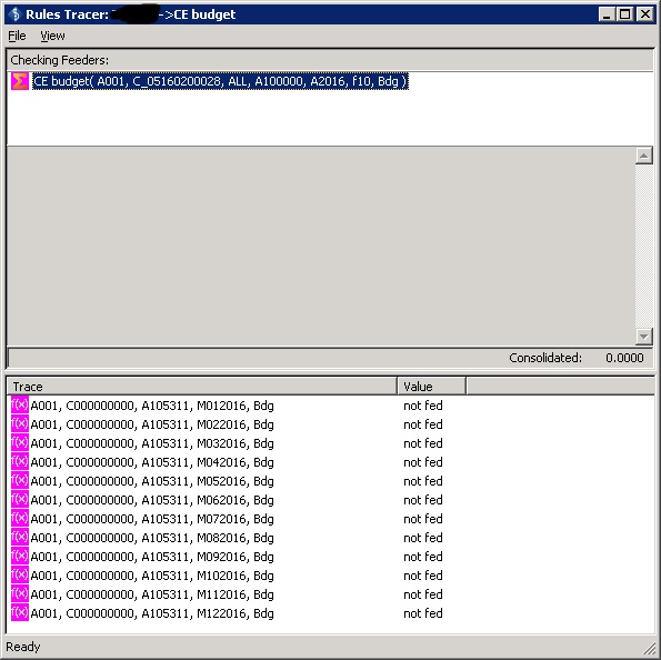

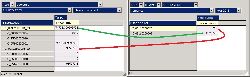

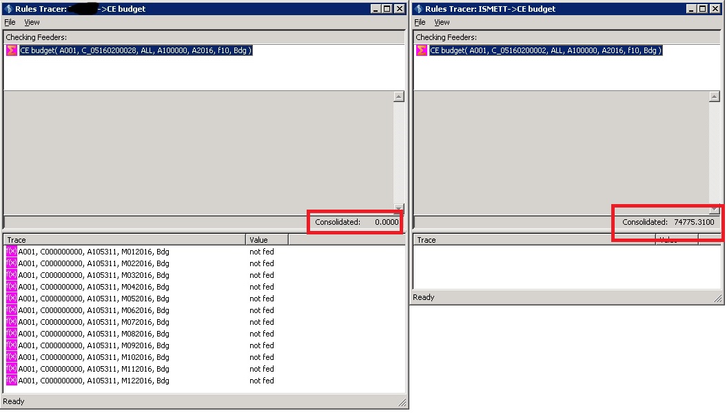

"Sometimes", this mechanism doesn't work :-( (see the attached images, please)
In fact, some cells in the 'CE budget' are well consolidated while others are not consolidated. Using "Check feeders" I noticed that leaf cells are not fed.
What does this mean??

Possibly due to using an attribute in your target - does reprocessing feeders or changing feeders and saving give you the correct result?
I know you said that you made changes to the rule but can you check if when you have the non-feeding scenario, change rule (to re-feed) do you get the correct results with each update/save?

After you had changed the attribute, the rule recalculated well, because rule recalculates every time you open a view.
The feeders fed 1 time to the old attribute value, when you entered the values to source cube. After the attribute value had changed, the feeders difn't refire (and sould not) to the new attribute.
Note that the feeder tracer vurtually "feeds" the whole feeder chain, so if you use it, it will show "Fed".
For this cases I make a websheet to edit the attribute values with big red "REFEED AFTER ATTRIBUTE CHANGE" and with action button which unloads the target cubes and refeeds the source and target cubes

The numeric feeders fire Once, when you enter the numeric value to source cube. If the condition changes (attribute, dimension change), the rule in target cube realculates correctly every time you open view. But nobody tell feeders to refire, so they remain in their old positions.
Another way to refeed: create a process with "Reprocessfeeders" in it. You can also want to unload a target cube to erase old feeders prior to refeed.
