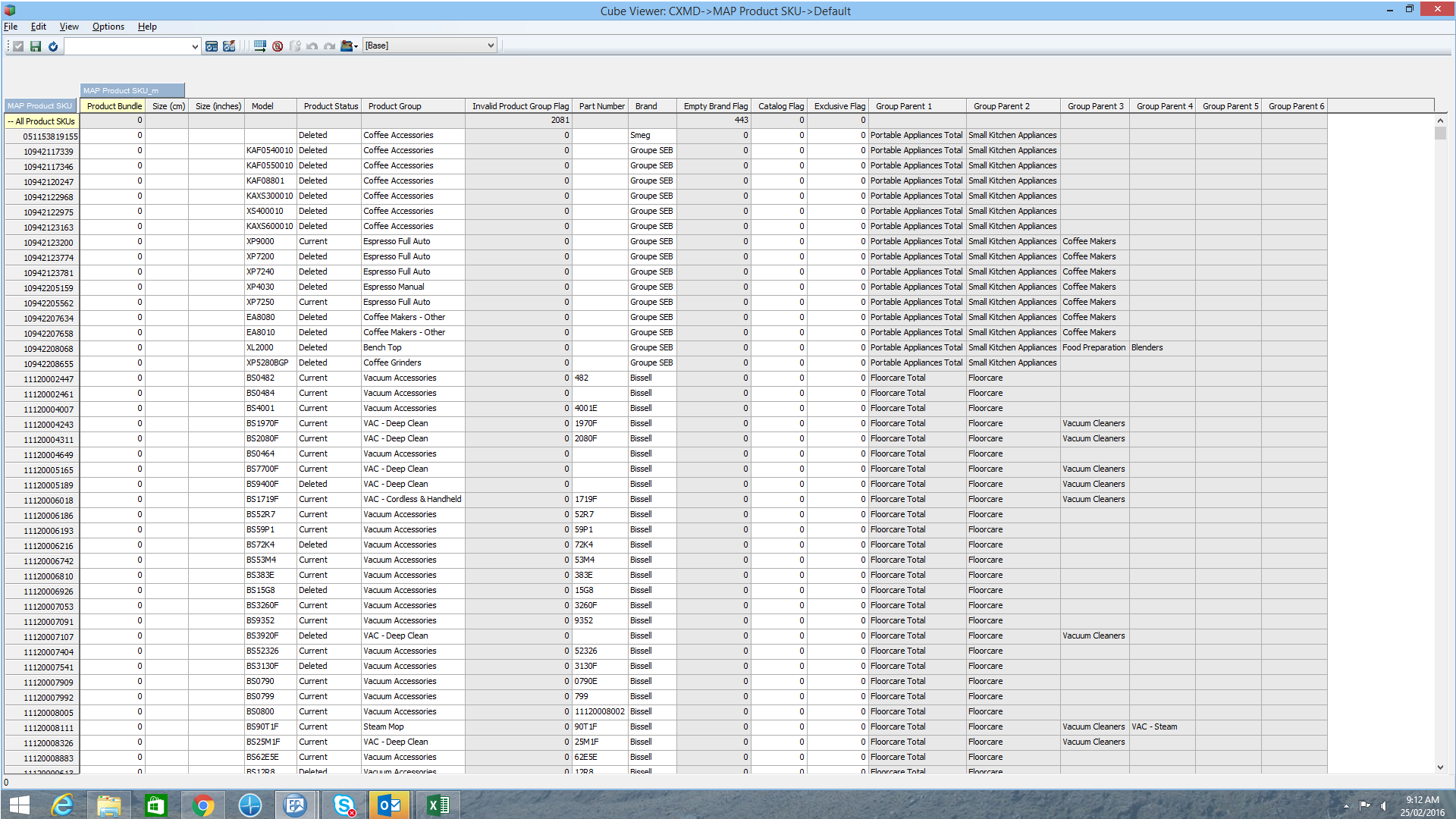

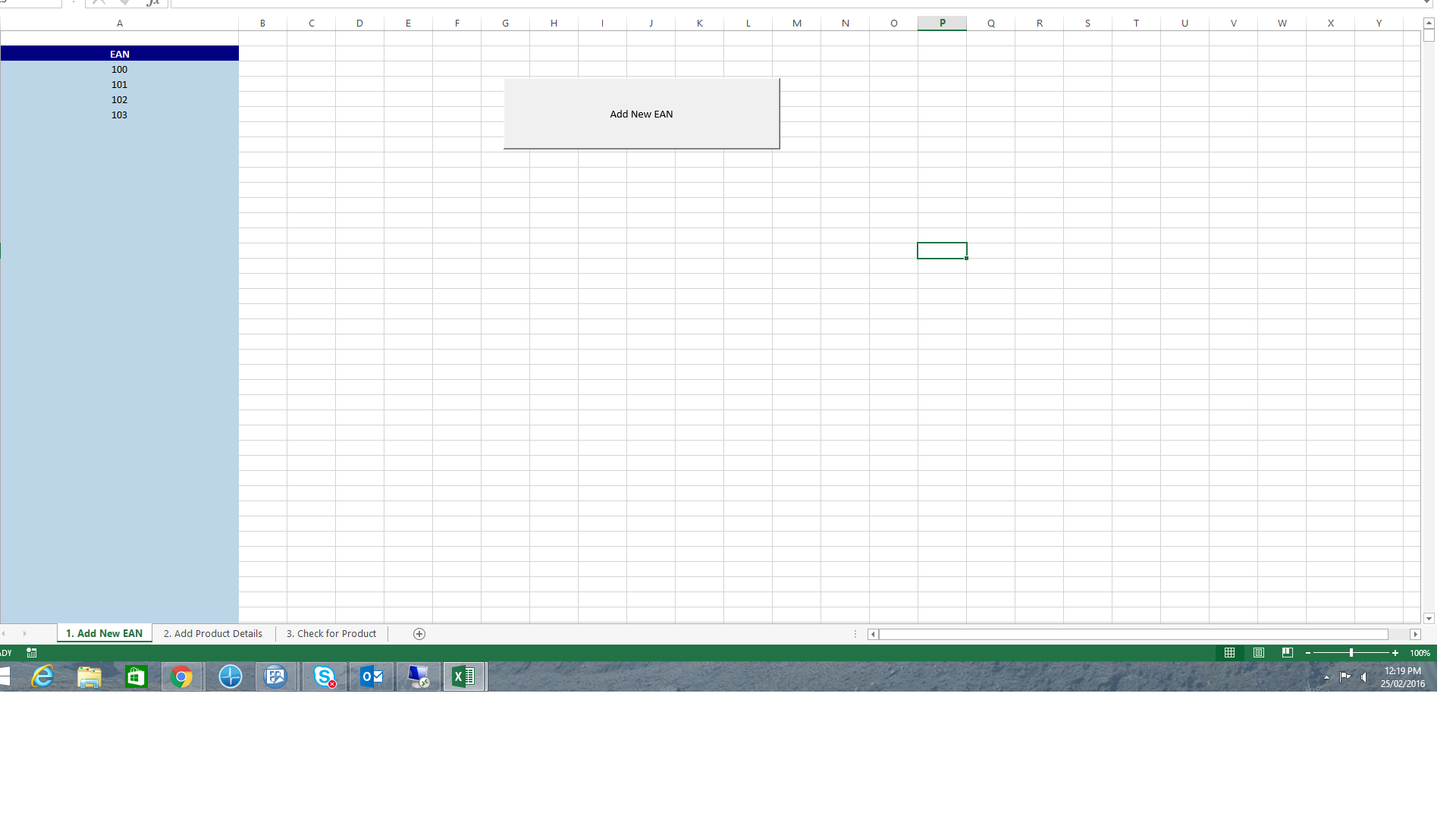

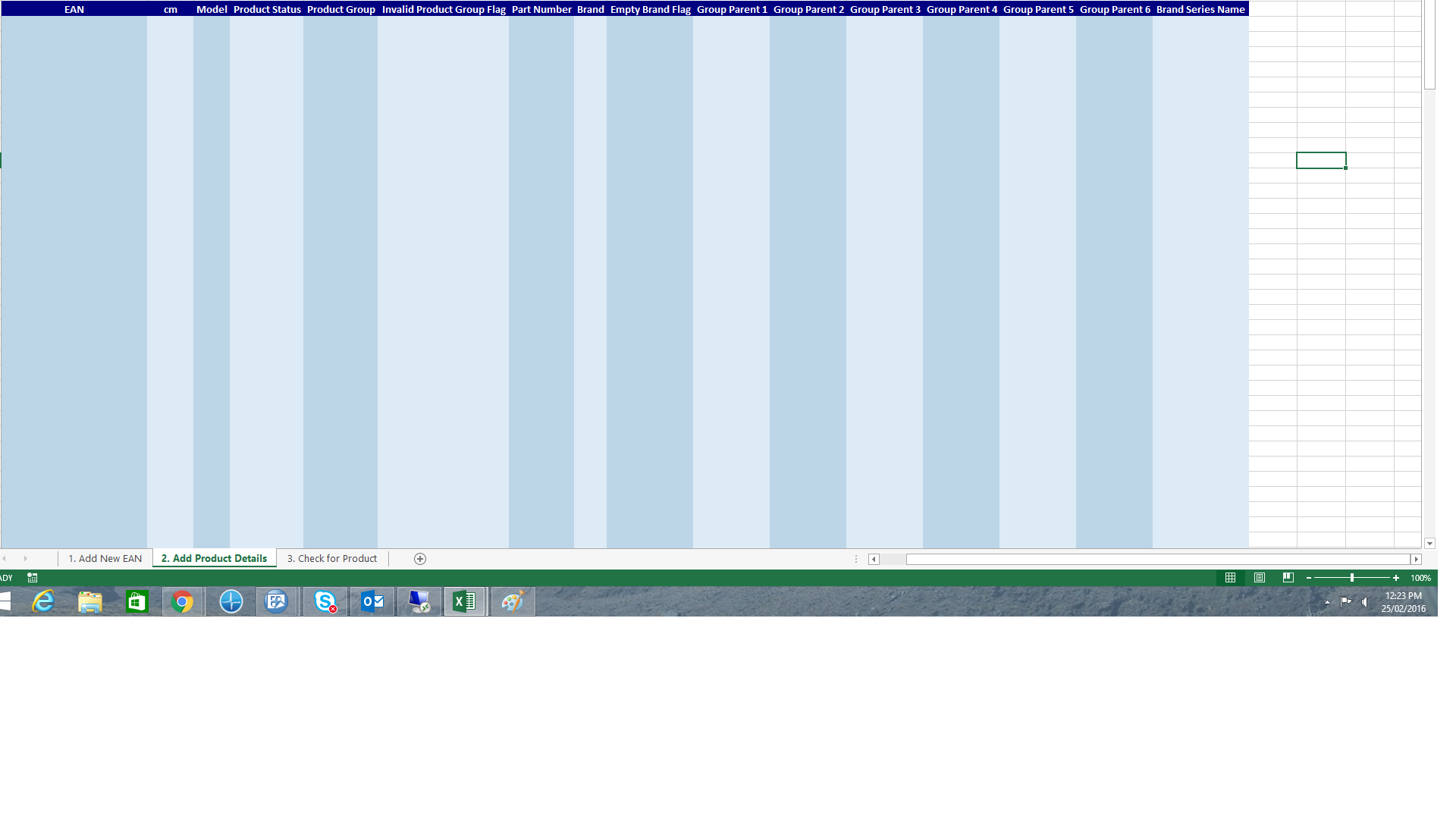

I think perhaps if you look at this screen shot here it may be easier to decode.
I've got 3 screen shots here:
1) MAP Product SKU - is a screen shot of the cube and the respective dimension I want to push it into. It is a mapping dimension for us to feed all our products (SKU/EAN -is also known as the product barcode)
2) Is a screenshot of the form I'm trying to create - it has 3 tabs - first one is pushing the elements into the MAP Product SKU dimension - first tab
3) Is a screenshot of the form I'm trying to create - it has 3 tabs - first one is pushing the elements into the MAP Product SKU dimension - second tab

What i'm more stuck on is screen shot one - what would the process be for inserting elements into a target consolidation and target dimension based on a list in excel?
Does the excel file have to be closed?
