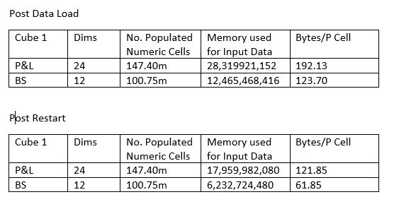

I am working on a TM1 (Version 10.2.2) database with two large reporting cubes. In the data load TI's it is necessary to use CellIncrementN rather than CellPutN, and it has always been the case that a significant amount of garbage memory is accumulated during a full cube load. I have always assumed this is due to the CellIncrementN function issuing a read query in a background and these results being cached. What I have also noticed is there is a significant difference in the memory used for stored input data, if I check immediately after a restart versus checking after executing the load TI's. Can anyone help explain how the value for memory used for input data in }StatsByCube is captured by TM1 as I did not expect executing a data load would change when the number of populated cells has not changed.

I agree that this does seem odd.
Firstly a "P&L cube" with 24 dimensions! Never seen that before, but let's move on.
More questions than answers in terms of what might be going on.
- is performance monitor on? (I assume yes as memory is changed even if # populated cells hasn't)
- have you checked that the DBRW formulas in the excel report to }StatsByCube are pointing to the correct measures?
- do you get the same result if you replace CellIncrementN with CellGetN + NewValue into CellPutN?
- the number of populated cells is the same but is the location of all leaf data the same?
Due to the "Trie" structure in which TM1 stores data the memory used per populated cell will depend on the dimensionality of the data and the indexing of the dimensions in the cube. This is why sparsity and dimension order is so important with regards to memory consumption and speed of retrieval. It is quite possible that for the same number of populated cells if the location of those cells changes then the memory required to store the data will also change. I would guess this is probably unlikely in your described scenario but you never know ....
Otherwise it it could be that what is reported in }StatsByCube is incorrect and there is memory used by feeders or memory used for calculations which is being counted in the memory for input data measure. Only someone from IBM with knowledge of TM1's internals would be able to give you a proper answer.

Thanks for taking the time to respond, some further info, I took a smaller example this time a cube with 9 dims and populated 2 million cells from a TI.
I tried various combinations of CellIncrementN, CellGetN + CellPutN, CellPutN on it's own.
Step 1 TI A. is executed, Cube is cleared using CubeClearData
Step 2 TI B. is executed, Data is loaded the memory used for input data is X, my source data does not have >1 value for any cube cell
Step3 TI B is executed again, overwriting all values in the cube, memory used for input data is increased to circa X * 1.8
Step 4 Executing TI B again further times does not increase the memory used for input data once the cell is initially overwritten
