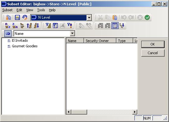

I was wondering how come when I typed SUBSIZ in VBA or directly in Excel I get a different value than you would see in SUBSET EDITOR. Even for someone with Admin rights I have access to all 24 elements but when I use the Subsiz function I ony get 3 as a result. Regardless the name of the user I log on I keep getting 3. Even when the Subset Editor says otherwise.
I'd also like to clarify one more thing. Why is it when I'm logged in as the Admin, the elements being returned is the Alias Name while for other users the element being retrieve is in its Original Element in this scenario a numeric value.
Cause If I try to read the script and from what i understood, it should be doing what I want it to do but its not.

I tried restarting Excel however the list of element does change to what is expect of the user.
I tried checked the {ElementAttribute_Store and all user group have write access to all Attribute. So this also makes me wonder how come there was one user when I loggd in, I got both alias and original element.

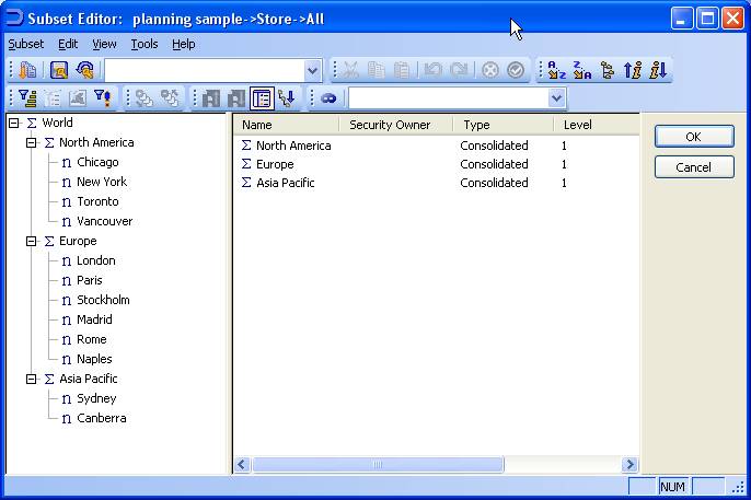

Scenario: Windows XP Professional (since unfortunately I don't have a spare Windows Server 2003 instance to test this on at the moment, but I doubt that it would make a difference). The TM1 server is running as a remote service, not as a Local server. The default Planning Sample server was used for the test. The client is Excel 2003 SP3.
I created a dimension called Store as shown in the following image:
Three security groups were created:
NthAmerica
Europe
AsiaPac
These were given write access to the corresponding consolidations and children.
Three accounts were created:
usr1
usr2 and
usr3, which were assigned to the respective security groups shown above. (usr1 to NthAmerica, usr2 to Europe, usr3 to AsiaPac).
Two public subsets were created; N Level, which is a static subset of all N level elements, and N LevelD, which is an MDX-generated dynamic subset of the same elements.
Under 9.4.1 MR1 with no fix packs applied, and 9.4.1 MR1 FP1, the following occurred:
- When the code was run under the first user's account (using either subset), the correct elements were returned in the list. This is the case regardless of whether the account used was usr1, usr2 or usr3.
- The correct elements were also shown subset editor.
If that user disconnected, and another user logged in in the same Excel session, then:
- When the code is run, the list belonging to the first user would still be returned, however
- The second user's elements would be correctly shown in subset editor.
If you then shut down Excel and log in as the second user, then
- When the code was run under the second user's account (using either subset), the correct elements were returned in the list.
- When you log out and log in as (say) either usr1 or usr3, you'll still get usr2's elements, however
- The correct elements were returned in the Subset Editor.
