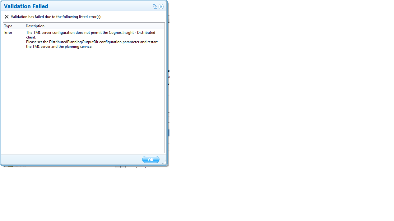

I am building an application in the TM1 application server to be later used with Cognos Insight. In order to deploy the application, I have received a message stating that I need to restart the TM1 server and the 'planning service. I have attached an image of the message.'
I am not sure what this is referring to as I do not see this in the services that are running. Please can anyone tell me where this is located?

The TM1 Server configuration does not permit xyz.
Please set the DistributedPlanningOutputDir configuration parameter
and
restart the TM1 Server and the planning service
TM1 Servers need to be configured, they are configured via the tm1s.cfg file in (or around) your DataDirectory
and
