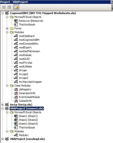

Can it be that my TM1 functions/macros that are doing connection (functions hidden behind the buttons) are changed/edit for internal company usage so it's not "N_CONNECT" anymore?
If yes, would you have please any idea in which section the 'connection command' would be?
I'm attaching the VBA explorer to show what is opening automatically when I open empty Ssheet (connect.xls)
Probably my problem here is that I'm not calling the correct function behind 'connection button'
Thank you
VBA explorer.jpeg (139.05 KiB) Viewed 26982 times

Re: Using VBA to connect to TM1 application
Post by LubosR »
...or maybe, do I need to copy declare functions into blank sheet all the time?
...probably not yes, as those functions are preloaded by default when I open any ssheet... ?
