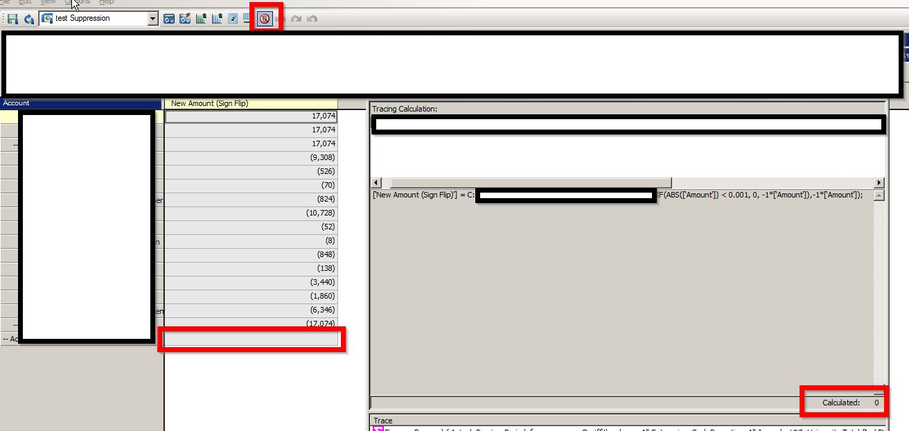

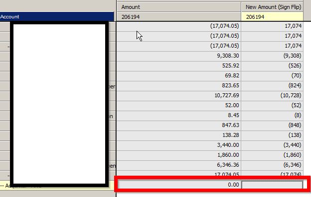

Whenever there is a very very small aggregation amount (e.g. 0.0000000043) in the cube view, TM1 can't suppress it at all in the activeform report. I mean, for business, they really don't care about this small amount and want to take it out from the report.
I have tried rule-driven amount based on roundp function to make that aggregation to be real zero but since it needs feeders from that small aggregation amount, TM1 still can't suppress it in the cube view.
Example is following, it is real 0 in new amount but very small amount in the amount. Anyone has better idea?

Thanks for the advice. I have applied the rule to the C level only coz it is just for consolidation. I know how exactly the suppression works.
a) Actually, for this issue, the rule won't work, for neither ABS nor Roundp function. You can use the function to make that consolidated cell a real ZERO but since you have to use feeders for the rule, TM1 will never suppress that cell because all child feeders under that very very small amount are not zero anyway after aggregation and this is the only way to feed that new amount. b) I have implemented this method in the report, hopefully, the user can accept it.

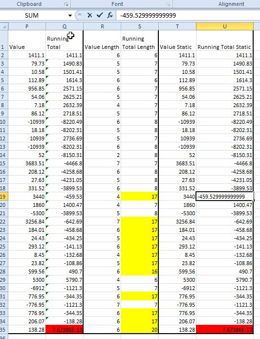

Thanks for the advice firstly. I have exported all the detailed values into a spreadsheet (and I have checked it also in the flat file format) and for those values from source system, they do have max decimal places up to 2. So the issue is not with source system but is in the process of aggregation of TM1 (which is similar in excel sum function). Please see the snapshot below. The first column are the exported values from TM1. The issue starts at row 19, which gives me lots of "9" as you can see and the length of that value confirms it as well. And it happens again at row 22 towards the end, which is showing very very small number at row 35.

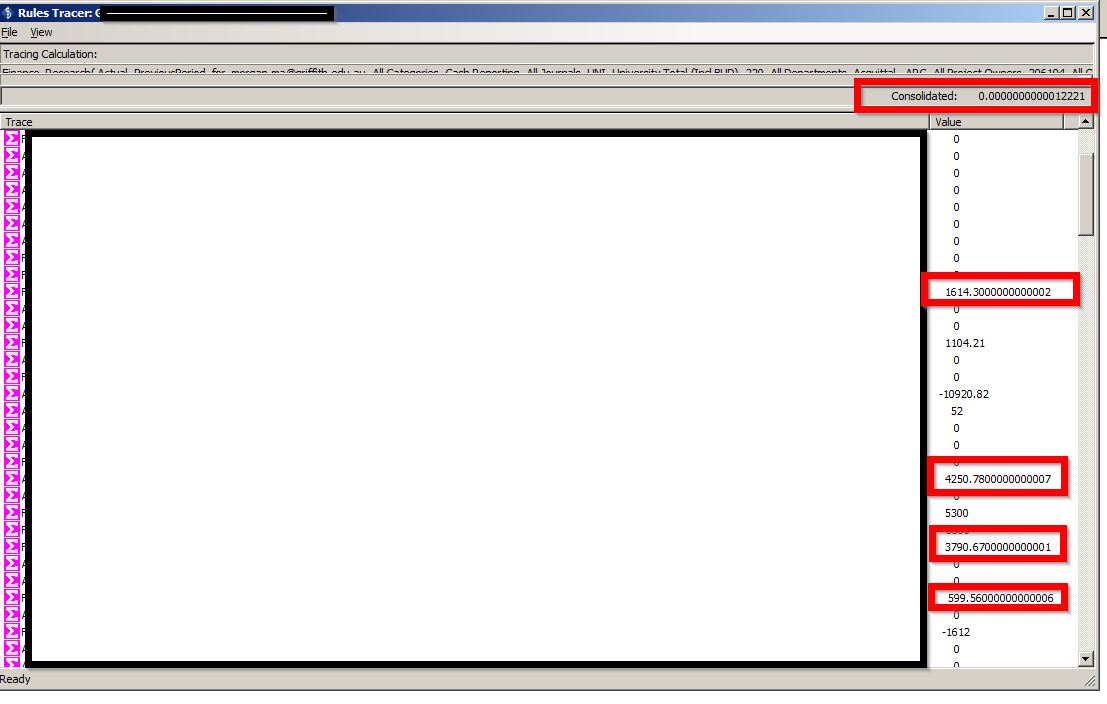

I tried this and applied this rule at N level only as well but no luck. I traced that calculation of the very very small amount. It is not a really zero. And you can see those long tails of consolidated parents, which cause this issue in the final aggregation.tomok wrote:If it were me and this was something that just absolutely had to be done I would create a new measure called "Rounded" and then make the rule (assuming you still want the pennies, if not you could round them off too):
You have to apply it at the leaf level for it to work properly with zero suppression. I know this works because I have implemented this approach before. Not ideal because it can greatly increase the size of your cube but if you absolutely want to get rid of the small amounts it's the only way I know to do it.Code: Select all
['Rounded']=N:ROUNDP(['Amount'],2);

One idea I looked at to try to resolve this was to multiply all values on entry by a large number eg 1000, etc, with the aim that eliminating the decimal places might then prevent the floating point arithmetic.
However, this still did not work in terms of zero suppression.
Even when I just use a consolidation with one element in each leg with a + whole number in one and a - whole number in another, the TM1 View will still not suppress zeros once the consolidation becomes 0 as they two numbers cancel each other out. The upper level consolidations are always shown.
Therefore I think that the underlying issue is due, not necessarily to the small numbers, but due to feeding. My guess is that it is the feeder at the base level which prompts TM1 to show the consolidations in a zero suppressed view.
Personally I think that this is actually a good feature. I have more users who are concerned about possible big variances being hidden at lower levels. This feature at least lets someone see at the top level whether a measure has a value so they they can drill down.
However, for your situation, this feature is causing your problems.
