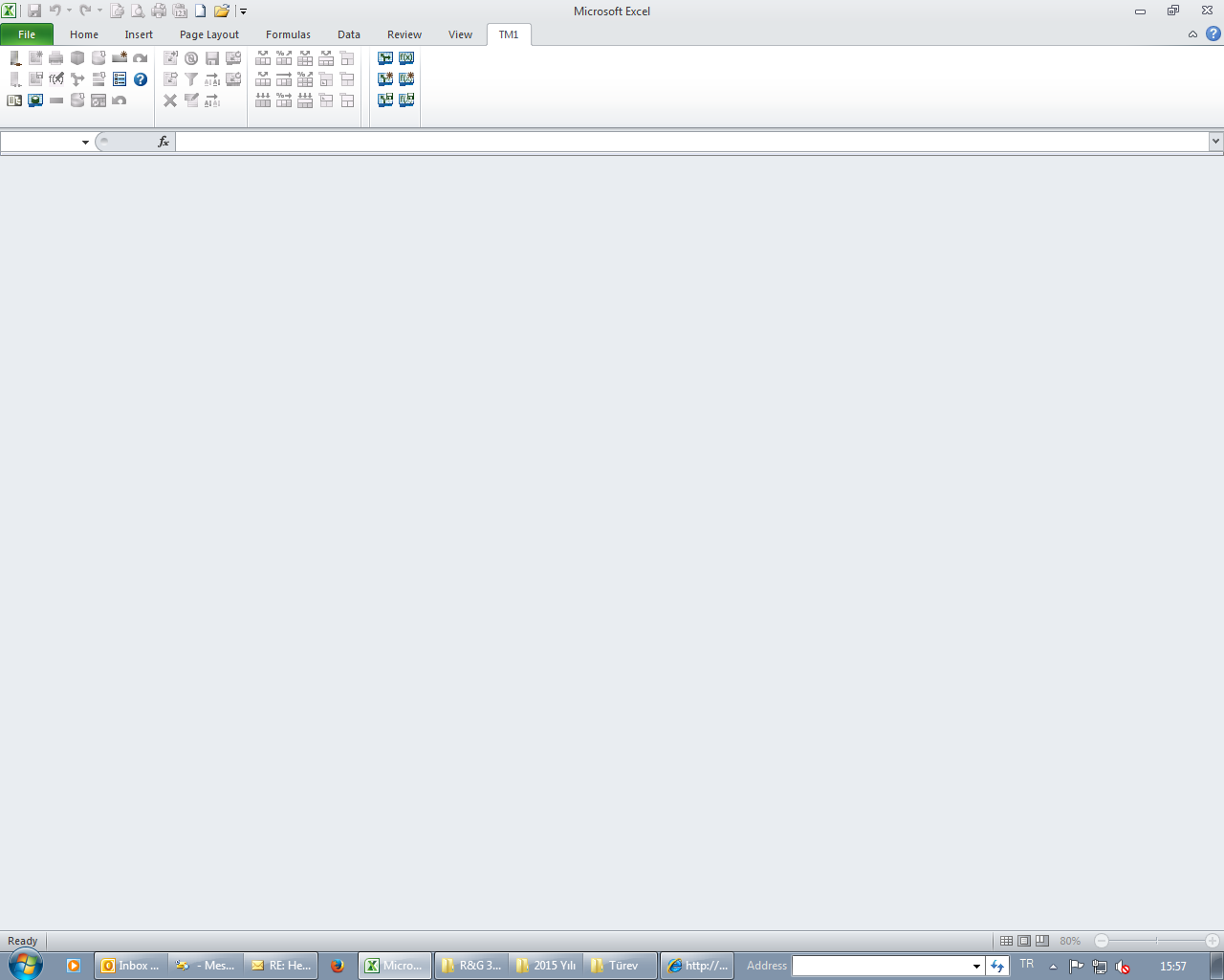

Sometimes when we connect to TM1 Perspectives, the excel's menu bar just being like at the picture. You can not see any writing , just the icons. Anybody have an idea why is that?

We also had the same behavior when wir run a VBA script.
the VBA ran on error and the labels of the toolbar disappeared - each with on error message.
the solution was: switch off the toolbar - run vba - switch on the toolbar.
maybe this could help?
