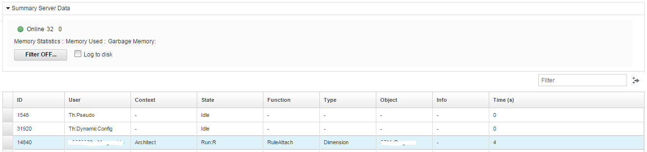

Here is my testing,
1. Attach the rule. (This rule takes forever to attach as the feeders is not proper.)
2015-09-30 09_09_28-TM1 Operations Console.png (23.8 KiB) Viewed 7226 times
2. Same in TM1 top. It is still running.

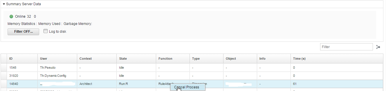

3. Cancel it in ops console.
2015-09-30 09_10_25-TM1 Operations Console.png (25.81 KiB) Viewed 7226 times
