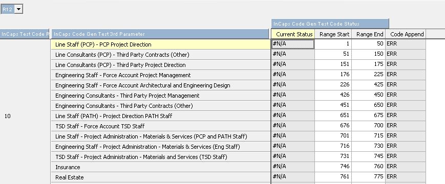

So I don't often hit rule issues but I've hit one that's making me scratch my head. Hopefully it's down to Fridayitis. I am however on the verge of doubting my sanity so I thought I'd better ask here before I go made.
So some background. I'm trying to build something that generates a sequential code based defined ranges. However numbers that have been already taken can expire and be reused. So I have built a cube that does this. I then have a summary cube that displays current status. The dimensions in each cube is as follows:
Summary
InCaps Facility
InCaps Test Code Result
InCaps Code Gen Test 3rd Parameter
InCaps Code Gen Test Code Status
Detail
InCaps Facility
InCaps Code Gen Sequential Code
InCaps Test String and Numeric

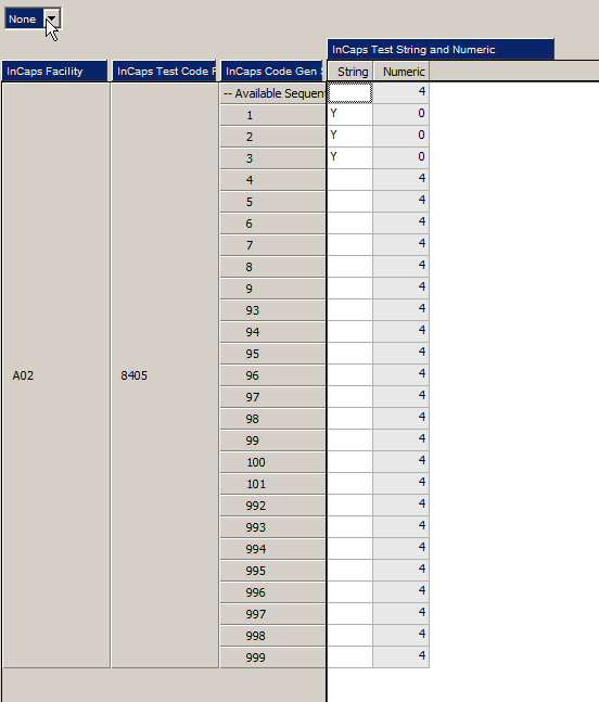

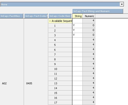

The summary cube looks like this:
The number goes down to 999 but only for certain combinations does it use all of them. Only 999 has a weight of 1 the consolidation Available Sequential Code which contains the next digit available for code generation. Those marked with Y have already been taken. Those with N (none visible in the screen cap) are unavailable

['Numeric'] = N:
IF(DB('InCaps Test Code Status Detail',!InCaps Facilities,!InCaps Test Code Result,!InCaps Code Gen Test 3rd Parameter,!InCaps Code Gen Sequential Code,'String')@='N'
    ,DB('InCaps Test Code Status Detail',!InCaps Facilities,!InCaps Test Code Result,!InCaps Code Gen Test 3rd Parameter,
           Str((Numbr(!InCaps Code Gen Sequential Code)-1),3,0),'Numeric')
    ,IF(DB('InCaps Test Code Status Detail',!InCaps Facilities,!InCaps Test Code Result,!InCaps Code Gen Test 3rd Parameter,!InCaps Code Gen Sequential Code,'String')@='Y'
         ,IF(DB('InCaps Test Code Status Detail',!InCaps Facilities,!InCaps Test Code Result,!InCaps Code Gen Test 3rd Parameter,!InCaps Code Gen Sequential Code,'String')@='' &
                   Str((Numbr(!InCaps Code Gen Sequential Code)-1),3,0),'Numeric')=0
              ,Numbr(!InCaps Code Gen Sequential Code)

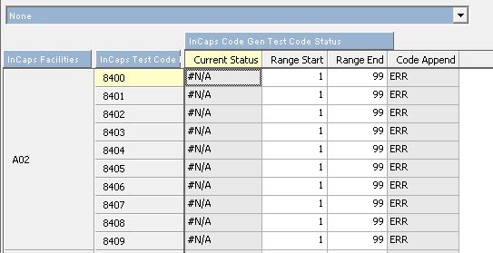

In the Summary cube there is current status. This should point to the available sequential code. The summary cube looks like this:
As you can see I'm getting #N/A in the cubes. Here are the rules for the summary cube:

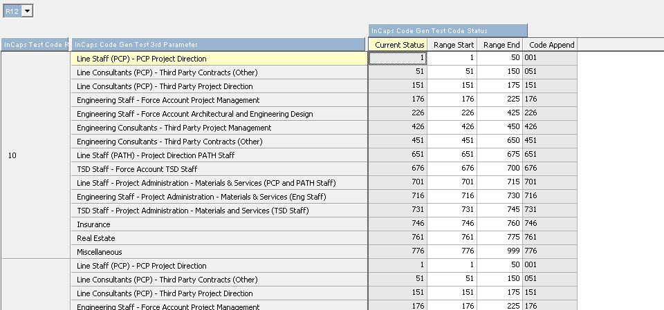

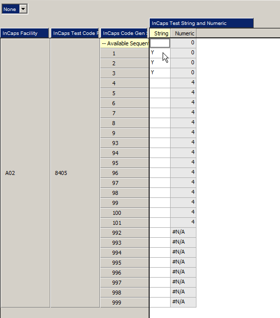

The bizzare thing is that if I calculate in the detail cube the #N/A disappears and the values appear.
I have tried saving rules and restarting the server, just in case there was an issue with cube dependencies.

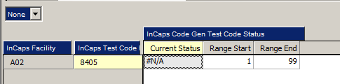

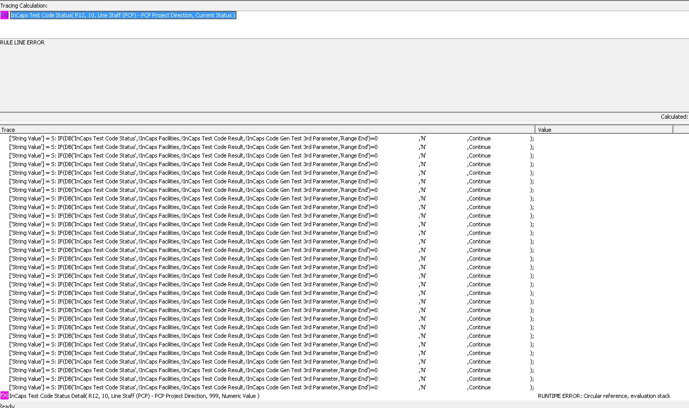

The plot thickens. So when I get an error with the calculation when opening the summary cube the rule tracer gives me a circular reference error for the rule in a lower cube which is a simple check against different values:
However once I calculate the values in the sub cube and recalculate in the summary cube, the values come through and the circular ref goes away:

This is interesting and I have reproduced same error in my environment. I have tried to keep the rule as minimum as possible to make is simple.
To be summary, I just tell you what I have found. There are two circulations.

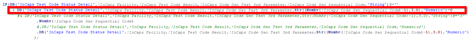

1. The Numeric function can be simplified and if you keep that condition, there will be '#N/A' showing for '999'. So I use the String condition to replace it. So there is no NA at all.
2015-09-15 15_11_13-Rules Editor.png (49.84 KiB) Viewed 8914 times

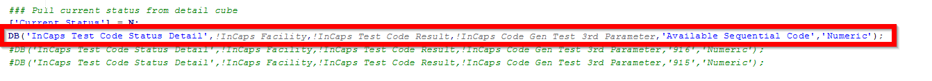

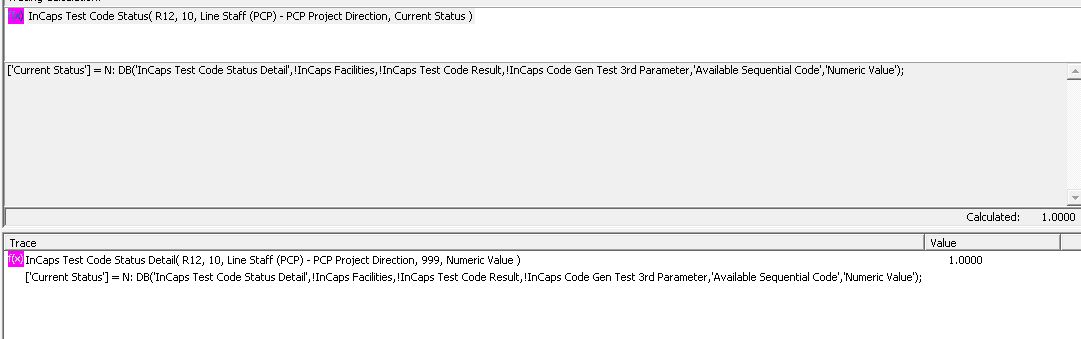

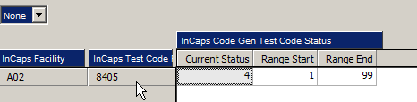

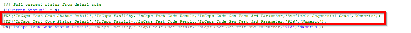

2. For Current Status, if you use the parent, then it will be always NA. If you use '916' and above, it still show NA. But if you use '915' and below, then everything would be perfect.
2015-09-15 15_44_58-Rules Editor.png (11.68 KiB) Viewed 8914 times
2015-09-15 15_55_01-Cube Viewer.png (3.66 KiB) Viewed 8914 times
This makes me thinking that although I can't find an NA from my cubeview, TM1 somehow still can't aggregate them, which means there is still some NA in some elements above '916'. That's why I am taking the current status from a specific element.
I have attached the rule codes for your ref. (I use InCaps Facility rather than InCaps Facilities :))

Feeders;
#['Numeric2'] => ['Numeric'];
#['Numeric'] =>
#DB('InCaps Test Code Status Detail',!InCaps Facility,!InCaps Test Code Result,!InCaps Code Gen Test 3rd Parameter,!InCaps Code Gen Sequential Code,Str((Numbr(!InCaps Code Gen Sequential Code)+1),3,0),'Numeric');
['Available Sequential Code','Numeric']=> DB('InCaps Test Code Status',!InCaps Facility,!InCaps Test Code Result,!InCaps Code Gen Test 3rd Parameter,'Current Status');

Data in Detail cube.
2015-09-15 15_54_41-Cube Viewer.png (14.97 KiB) Viewed 8914 times

Post by macsir »
Situations in Error for the first circulation.
2015-09-15 16_01_37-Cube Viewer_.png (17.2 KiB) Viewed 8912 times
2015-09-15 16_01_10-Rules Editor_.png (20.47 KiB) Viewed 8912 times
macsir
Posts: 785
Version: PAL 2.0.9
Re: Rule Issue
Post by macsir »
Situation in Error for the second circulation.
2015-09-15 16_06_33-Cube Viewer_.png (4.1 KiB) Viewed 8912 times
2015-09-15 16_06_08-Rules Editor.png (11.23 KiB) Viewed 8912 times

Wow. Many thanks. That's really helpful. I do however have 1 issue. The key requirement is that the codes can be generated from 1-999, so 915 is too low. I am however going to change things to a string and see if that helps. If I'm still getting an error I'm going to fire this one over to support. I'm also going to try and make sure we replicate it in 10.2.2 as we are running 10.1.1 at the moment, taking away their standard "upgrade" answer,
Jim.

Did you notice any stack overflow error in TM1 server log ?
I didn't really look through the code but I suspect you are doing referencing in a circular manner and hence resulted in typical stack overflow, which is not a TM1 bug.

There are indeed stack over flows in the code. while the rule is kind of circular in nature at no point is anything referring to itself. Hence my trouble understanding why I was hitting the issue.
Re: Rule Issue
Hi Jim,
Isn't this is the same problem as you get in for example daily cash flow statements where day 2s opening balance is linked to day 1s closing balance and appropriately fed? Pretty sure what you are seeing is the same behaviour as I see when the break points in the rule and feeder flow are not set up correctly.
Once the stack is broken the whole (set of) cube will mis-behave and the exact nature of this has varied by version.

Thank you very much guys for all your feedback. It looks like I'm going to have to move some this in to a TI statement. This isn't a disaster as there is a TI in place that is used to create a code based on user selections anyway. While statement here I come.....

I have to resolve to TI in some of our cases as there is simply no way to go around the stack limit. Can't blame TM1 though.
