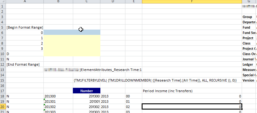

Yes, I have already tried. I have created a time dimension with year and month and using its attribute cube as based to get values from the source cube. But it looks like it can't get values in second DBRW. E.g. it should show values on 2013 02 row.

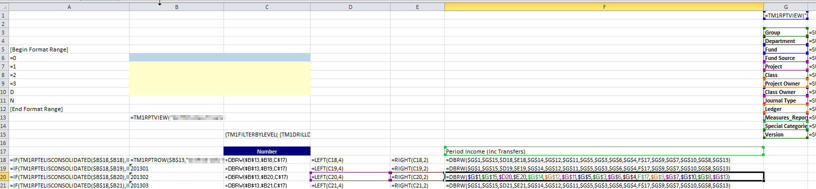

Actually, after turning on Auto Calculation in excel and rebuilding the sheet, it is showing Key Error but all formulas are in its own right dimension positions.

You can't have DBRW formulas that reference values from other DBRW formulas. This is pretty common knowledge. Change the cells in column C to DBR.

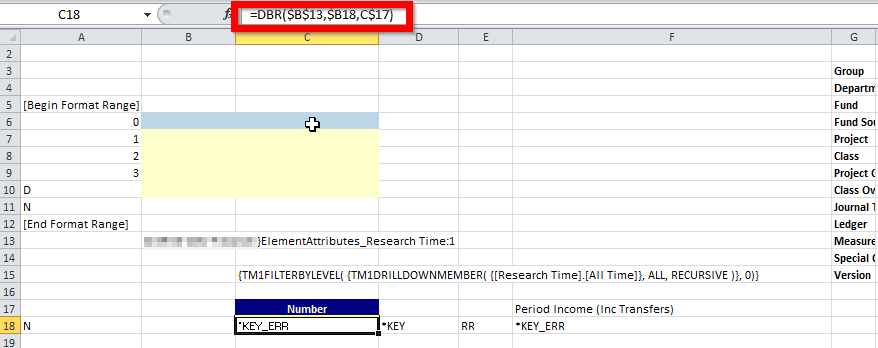

I tried it as well.
All in Key Error.
2015-09-02 11_28_38-Microsoft Excel - testMDX2.xlsx.png (18.66 KiB) Viewed 6989 times

Okay, DBR function is the first one to execute in Activeform so any formula inside it won't run untill itself finishes. That's why it is showing error on DBR. I am in the loop now... :?

I have no idea why you are doing what you're doing. You already have the YearMonth elements in column B, why on earth pull the value converted to numeric with a DBRW in column C and then convert that back to text and split it? Frankly that's plain dumb, just use a LEFT, RIGHT or MID formula on column B in columns C & D to get your year and months and the job is finished.

Oh, how silly of me! Thanks for pointing that out, lotsaram. :D
Yeah, you are right but the root cause is that I haven't pointed elements into right dimensions which I figured out later. :oops:
