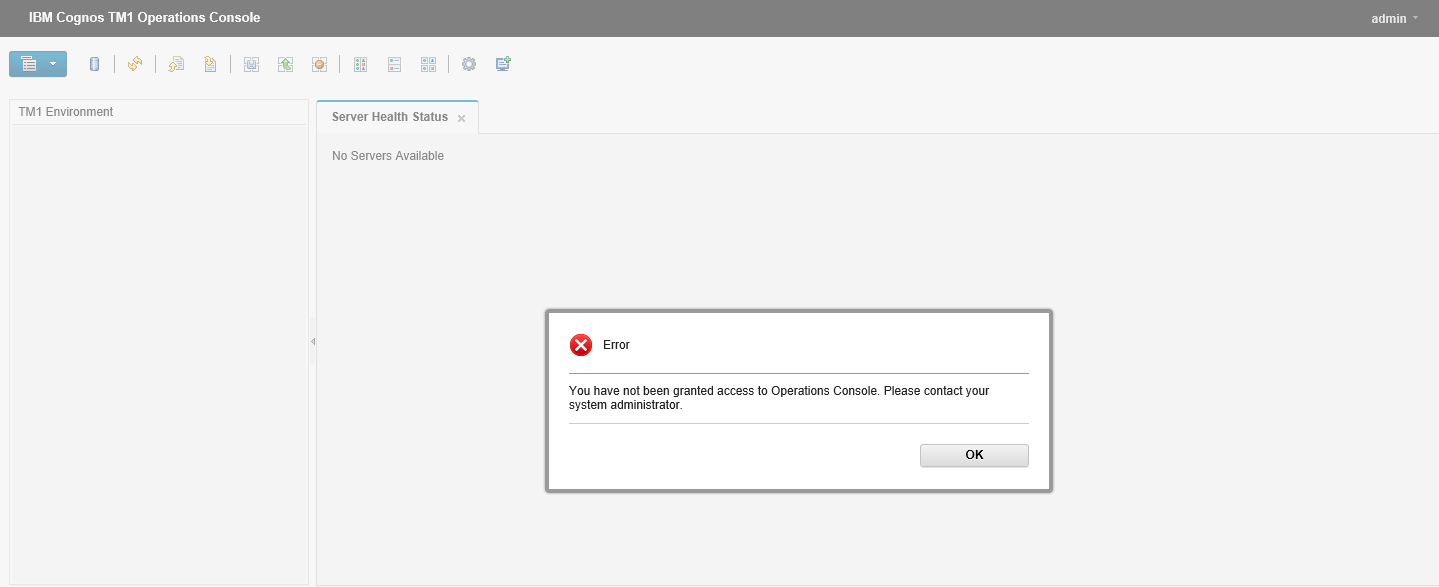

Any one have come across with the same error attached and have fixed? please suggest me ...
I have added a server and observed the users connected and later after a day, when I re-login back , I came across this error.
default configuration:
Default server : SData
Default Group : Admin
DefaultAdmin Host : IP address (I have even tried with FQDN)
Ops Console.png (29.84 KiB) Viewed 6310 times

syd wrote:Hi,
See this IBM technote.
Michel

I experienced recurring issues with Ops Consol (I can't recall the exact detail as I don't use it in my current company), however the issue resolved if you deleted the server from Ops Console and then added it back again. Might be worth a try?
