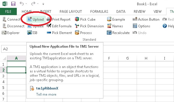

There is another way of giving the Perspective Views to the client (End Users).
You can upload the Perspective View to the TM1 Application Web.
Roy.
Roy.
