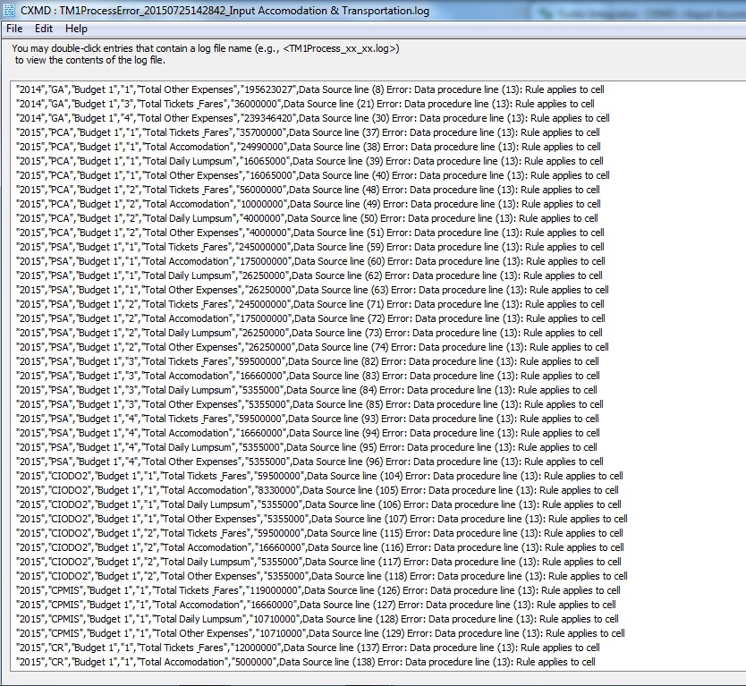

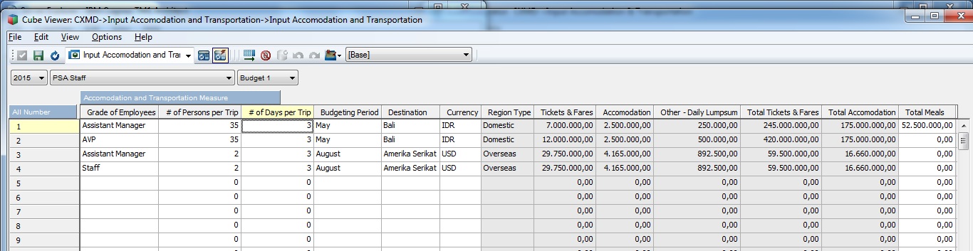

Hai guys,
I need help here. I've made to copy the value but there's still a view error
this is the cube that i want to copy the value from budget 1 to budget 7
and this is the formula that i make in Turbo Integrator in tab prolog :
When i run the process the message log pop up like this picture bellow .
can you help me how to solve it ....

- Posts: 6672
Re: Create parameter process using none datasource
From the Request For Assistance Guidelines, which should be read thoroughly, with the relevant parts highlighted:Chita wrote:Hai guys,
4) Similarly if you're getting unexpected results, specifics of what you're running, how, and what results you're getting will yield a more valuable response than "I'm running a T.I. but my code doesn't work properly". If you're getting an error, please be specific about what the error is (full details, not just "a runtime error" or "process terminated with errors"), and the circumstances under which it's occurring. But remember that even if you do specify the exact error message, it's not likely to be helpful unless you provide the context for it; which part of the software the error is occurring in (point 2 above), and what, specifically, you were doing at the time.
5) For Rules and TurboIntegrator processes, posting the actual code and the real names of and structures of your cubes, dimensions and elements will be a thousand times more useful than an attempted description of them. You don't need to post real data, but the real code is needed. Pseudo code is obviously not "the real code". When you post something like "Suppose I have cube A and Cube B, and my rule is ['value'] = N:DB('CubeA', 'dim1, dim2'" etc, then three things happen. One, you reduce the chance that a syntax or typing error will be spotted, which means wasting time bouncing posts back and forth to try to get to the root of the problem. Two, you are usually describing what you think is happening, which may not be what is happening. Three, some more experienced members won't even look at the question because they've had too much time wasted by the first two issues in the past. You can upload entire .pro, .cho or .rux files as attachments if necessary, or just copy and paste the relevant part into your post using the Code tag at the top of the post editing window.
- Posts: 6672
OK, based on the code that you've now added to your edited post you appear to be well and truly on the right track. I think that your problem is here, in the code on your data tab:Chita wrote:Hai guys,
As per the screenshot that you posted (and for the benefit of those reading this in the e-mail notification feed), you're getting "Cell Type Is String" errors.Chita wrote:Code: Select all
And this is the formula that i make in tab data : #******************************************************************************* # Write targeted cells if updateable #******************************************************************************* IF ( CELLISUPDATEABLE ( 'Input Accomodation and Transportation', vYear, vOrganizationUnit,P1, vNumber, vMeasure) =1 ); CELLPUTS(SValue, 'Input Accomodation and Transportation', vYear, vOrganizationUnit,P1, vNumber, vMeasure); CELLPUTN(NValue, 'Input Accomodation and Transportation', vYear, vOrganizationUnit,P1, vNumber, vMeasure); ENDIF;
Here's the problem. You're testing whether the cell is updateable, which is fine. However that's just a test to determine whether all of the elements are at N level and not defined by rules. If the cell passes that test then you are trying to write both a string, and a numeric value to that cell. One or the other of those is going to be wrong. What you therefore do (assuming that the measures in both cubes are the same) is to test the value of the VALUE_IS_STRING TI Variable. (See the link for the syntax.) If VALUE_IS_STRING returns a non-zero value then you use the CellPutS function. If it returns zero then you use the CellPutN function. You don't use both of them as the code block above does, because if you do one of them will be wrong and will throw the type of error that you've shown.

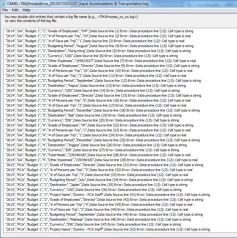

Thank you for your reply,
i've changed my formula in tab data :
IF
( VALUE_IS_STRING =1,
CELLPUTS(SValue, 'Input Accomodation and Transportation', vYear, vOrganizationUnit,P1, vNumber, vMeasure),
CELLPUTN(NValue, 'Input Accomodation and Transportation', vYear, vOrganizationUnit,P1, vNumber, vMeasure));
the messaoge log doesn't show like before but it's changed like this picture bellow. Is that okay to keep the message log like that cause i dont understand how to fix it..
IF

- Posts: 1833
The 5 column of data in all the lines I can see of the error file has "Total" in the element name so I assume it is a consolidated cell; and you are trying to move a value from a consolidated cell in Budget 1 to a consolidated cell in Budget 2; the error "Rule Applies to Cell" will appear if you try and put a value in either a rule calculated cell or consolidated cell (essentially a consolidated cell is a rule derived cell).
Based on what you are trying to do with your TI, I would imagine that you should be perfectly fine just setting the source view to skip consolidations. That would result in those lines of data not being processed.
But i still have message log "Rule applies to cell"..
i've make Function ViewExtractSkipRuleValuesSet but it doesn't work ......
Please any advice ???

The message :
Error "Rule applies to cell"
Which part of my tab data rule that should i fix .. ????

The message :
