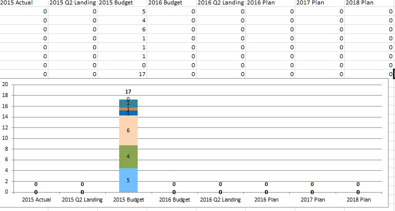

  • We created a very basic slice in Perspectives, on which we built (again a very basic) stacked chart:

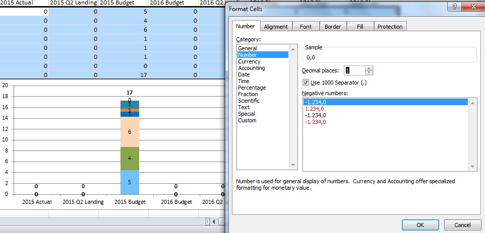

  • After this we format the table to add one decimal digit:

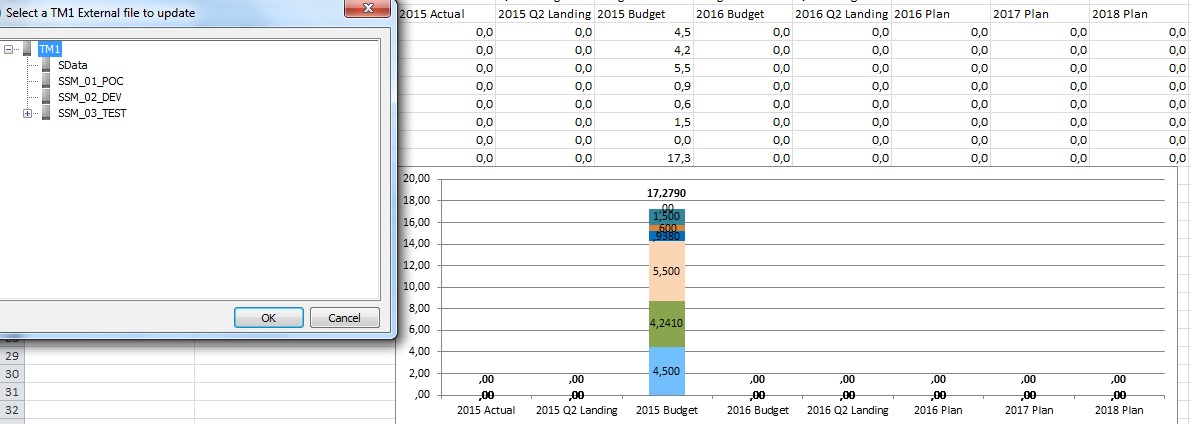

  • Next, as soon as we want to upload / update the template to / in the applicatons folder, the number formatting on the chart's data labels completely changes:
After this, when you try to re-open the sheet from the applicatons folder, it shows the wrong number formatting until you hit Excel's local save button, at which point the numbers are back to normal again. Very strange behavior if you ask me, maybe it has something to do with regional settings, but so far we haven't been able to solve it. Also can't seem to reproduce the issue on my local virtual machine...

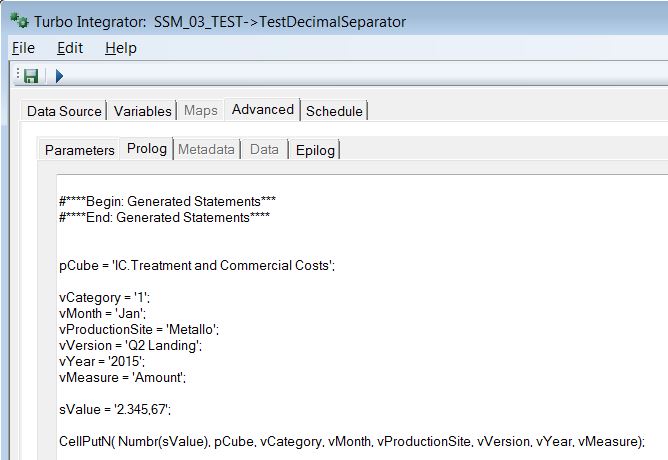

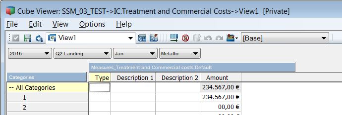

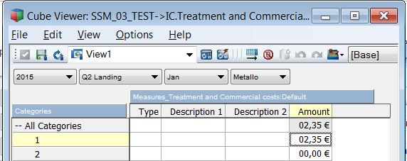

Attached a few screenshots, displaying two very simple examples of a process performing a CellPutN function.
  • In the Process_01 example we’re trying to write ‘2.345,67’ to the cube after converting the string value to a number using the NUMBR function. As a result (Result_01.jpg), the value in the cube shows 02,35. So it seems like the dot is treated as the decimal separator and the comma is ignored.
  • In the Process_02 example, where I removed the dot as thousand separator in the input (sValue = '2345,67'), the number written to TM1 is ‘234.567’ (Result_02.jpg), which again indicates TM1 ignores the ‘,’ as decimal separator.
I’ve ran through the regional settings on the server side with the client’s server administrator and we’ve made sure all the regional settings are reflecting the ‘,’ sign as decimal separator, so I don’t quite understand what is going wrong, or which configuration or parameter we’re overlooking.

The thing that you are overlooking is:
TM1 Reference Guide wrote:The string passed to the NUMBR function must use. (period) as the decimal separator and , (comma) as the thousand separator. Any other decimal/thousand separators will cause incorrect results.
Give this a go instead:
StringToNumberEx(String, DecimalSep, ThousandsSep);
