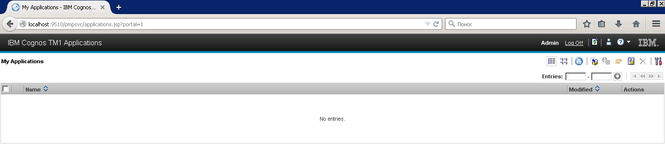

I have an issue creating a new application: the administration button becomes inactive and the application is not visible:
1. When there is not any application in TM1 App Web, the admin button is active:

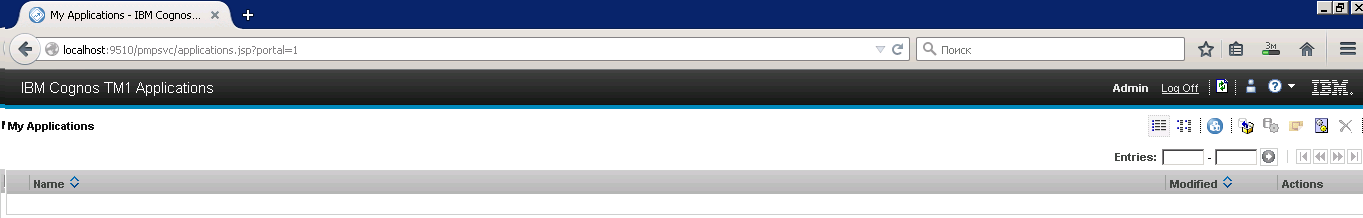

2. If I create an application (central in this case), the admin button becomes inactive and the application is not visible:

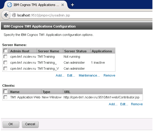

3. I can manually enter the admin site: http://localhost:9510/pmpsvc/sysadmin.jsp
It says that the application is created and inactive.
The user is admin on both servers. The password is empty on both servers.
