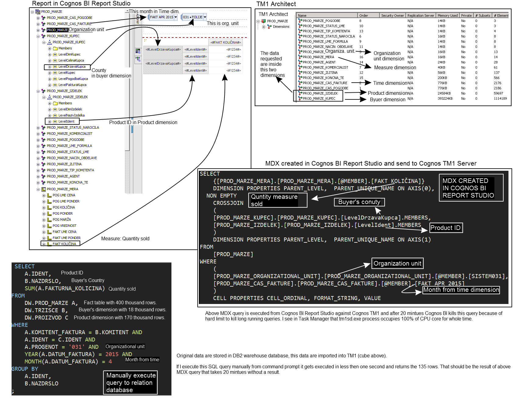

I have created quite simple report "Quantity sold" measure in Rows with "Buyer's Country" and "Product ID" in Columns.
Report created in Cognos BI Report Studio accessing data from TM1 cube. Cube is quite sparse and result is for sure result of sparse data. The query in Report Studio is executing 20 minutes with killing report after this time (Cognos BI hard limit in our environment). From Windows Task Manager I see tm1sd.exe process occupies 100% of CPU core all the 20 minutes time.
If from command prompt I manually execute query directly to the warehouse database (from where TM1 cube data is imported during the night) the SQL query runs for less then one! second.
Are there any basic steps (recommendations) I should check in TM1 to see if I can dramatically speed up this query execution? What are basic steps to speed-up sparse reports?
See attachment for details.
Thanks.
Thanks.

- details.png (246.99 KiB) Viewed 13960 times

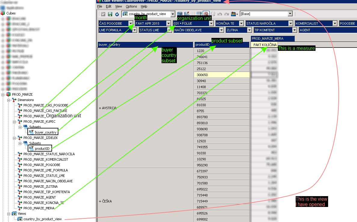

I did the following:qml wrote:As to checking the view in Cube Viewer, I was thinking of creating a view manually to see if it takes long to run. This would allow you to remove Cognos from the equation and check your performance in pure TM1. If a view with 135 rows takes more than a few seconds to return results then your model is poorly designed. Any caching etc would only be covering the problem, not solving it. Also, you can create a cube view using TI, but it shouldn't be necessary, you should be able to create a crude drag-and-drop view corresponding to your BI report in a few minutes.
I. Create dynamic subset for Buyer Country level
1. Right click on Buyer dim | Insert new Subset.
2. Subset Editor opens. Menu: Tools | Record Expression.
3. All button to make sure all members are displayed.
4. Click Filter by Level and select level 3 (TM1 starts counting from 0 to n from bottom-up).
5. Tools | Stop Recording and answer Yes.
6. Subset | Save, named the report "buyer_country", unchecked the Private button (make sure Save Expression is checked).
7. Checked the created MDX with View | Expression:
{TM1FILTERBYLEVEL( {TM1SUBSETALL( [PROD_MARZE_KUPEC] )}, 3)}
II. Create dynamic subset for ProductID level
The same steps as in I. Subset name: productID
Created MDX is:
{TM1FILTERBYLEVEL( {TM1SUBSETALL( [PROD_MARZE_IZDELEK] )}, 0)}
III. Create view
1. Right clicked and selected Browse to open Cube Viewer.
2. In Rows I click on my measure dimension and selected my measure FAKT KOLIČINA (English: Quantity sold).
3. In Columns I drag buyer and clicked on it to open Subset Editor. Menu Subset | Open and selected "buyer_country" subset.
4. Like step 3 for ProductID.
5. From time dimension I have selected "APRIL 2015" and from organization unit dimension I have selected "031".
6. In Cube Viewer selected Options | Suppress Zeros.
7. File | Save a report name it: "country_by_product_view" (unchecked Private at saving dialog).
8. Clicked on Recalculate button. Building Views dialog opens, but after exactly 5.3 seconds I got results in Cube Viewer.
I checked the data and it looks like the data are exactly what I need.
IV. Launched Cognos BI Report Studio and executed report from my first post in this thread. The created TM1 view and Cognos BI report looks the same(see attachment). But report in Cognos BI takes for ever. After 10 minutes I have killed the report. During execution I have opened Windows Task Manger on Windows server and I see tm1sd.exe is occupying 100% of one CPU for whole time. Don't know why, but it looks like this TM1 view is not excepted.
I have got SKIPCHECK and also the FEEDERS in the rules. But for above tests I have just deleted rules to make sure rules are not a problem. So tests are without rules.qml wrote:As to the rules, it doesn't even matter if you're pulling any rule-calculated values into your report. You need to have SKPICHECK and FEEDERS in a cube of this size, otherwise it will never work. Any rule added to the cube switches off its sparse consolidation algorithm, making it much slower. In your case, if you really do not use SKIPCHECK it's probably about 27 orders of magnitude slower (no kidding).
- cube_viewer.png (165.85 KiB) Viewed 13794 times
