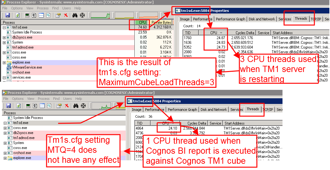

I was sceptical about this, but at least if there is multiple CPU threads are used it should be at least some performance increase. Now I have been monitoring with Process Explorer (freeware tool), to see if multiple threads were used during report execute, but it never was. So I suspect that this multithread support does not work in my case (see print-screen cpu_threads.jpg bellow).

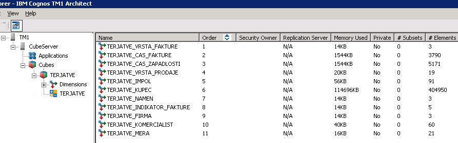

Can you please point me to some documentation how to do this? What do you mean by "how log the view takes to calculate"? I don't use any views in TM1 - see views.jpg - I was never able to establish Cognos BI to use TM1 views, so I don't use them. I don't know if this is not supported or I just was unable to perform this task.
