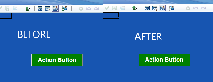

So a lot of things from the 80's have made a comeback but I just cant see silver 3d rectangular 3d buttons coming back into vogue anytime soon.
To change the appearence you can change the TM1web css file below
C:\Program Files\ibm\cognos\tm1_64\TM1Web\css\websheet.css
add the following lines of code to the end of the file, restart the website and hey presto flat action buttons
input[id^=TIButt] {
border: 0px !important;
This comes without any warranty and I know when you upgrade the change will be overwritten. But think of all the demos and presentations where you're extolling the virtues of web and TM1 only to hear the giggles when they see an action button.
See attached picture for before and after.
Steve

oh this should also work but I haven't tested across all browsers versions etc
.actionButtonControl
border:0 !important;
Steve
