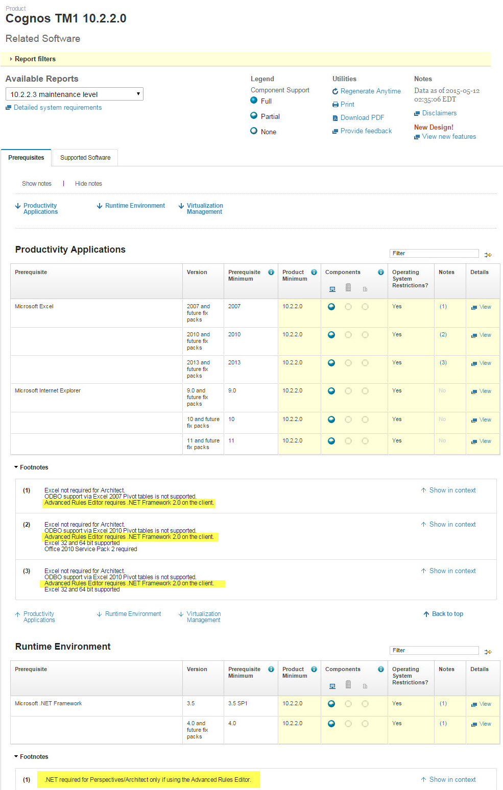

I do recall a time when end of life statements were embedded in searchable .pdf files so that we could at least do a search for them, find them easily, and know them. Instead, these days, we need to rely on dynamic bumpf like the all singing, all dancing IBM Software Product Compatibility Reports (SPCR) tool. Because such tools can, in theory, be reprogrammed to show modified versions of history, I grabbed a screenshot of the current incarnation for 10.2.2:
That's four references to the Advanced Rules Editor, zero to it being unsupported. In addition, the 10.2 New Features Guide makes no reference to the A.R.E. being dumped but merely says:
Microsoft .NET Framework 2.0 or higher is needed only for the Cognos TM1 Architect expanded rules editor.
