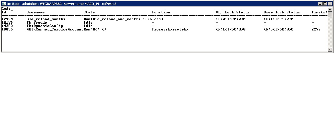

Hello Friends,
Need some urgent help from you guyzzz.....
I ran a chore ( a scheduled one ), in TM1TOP I am not getting any updates, and even the log files showing no updates......
Its jus showing the status of last process that ran as " finished executing normally, elapsed time 444.23 seconds ".
No error , No updates, What to do.
Even I tried to kill this thread, but even that is not happenning. ( screenshot attached ).
Kindly help, its very urgent.
Thanks....
TM1TOP_Screenshot
TM1TOP_Screenshot
mattgoff
Posts: 518
Version: 10.2.2.6
Excel Version: O365
Location: Florida, USA
Re: TM1 Data Load Failing everyday
Post by mattgoff »
Please a) stop opening new threads for the same problem and b) read the request for assistance guidelines.

Need your help guyzz,
I am facing the same issue as "http://www.tm1forum.com/viewtopic.php?f=3&t=8795".
In reply of this post a link is provided "https://www-304.ibm.com/support/entdocv ... wg1PM57320" posted by tm1novice; which I am not able to open.
Can somebody post the solution here in my post.
My TM1 process getting stuck and showing state=RUN and not allowing other processes to run.
Need your help guyzz.
