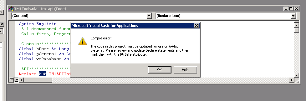

We have been utilizing a wonderful Excel add-in for the past 4 years developed by Alan Kirk and team (TM1 tools v1.0 build 158) - thank you! The latest issue is that we needed to upgrade Excel to a 64bit version (we are running TM1 10.2.2) and have found that the version of the add-in no longer is functional (error message attached - "Compile error - the code in this project must be updated for us on 64-bit systems. Please review and update Declare statements and then mark them with the PtrSafe attribute.". While I am highly dangerous in excel, I have no idea how to go about fixing this issue and am very much hoping there is either a newer version of the Excel add-in to address or otherwise there is another workaround so we can utilize Excel 64-bit. Any suggestions/assistance would be greatly appreciated.
- Screen shot of VB error message
- Capture.PNG (17.61 KiB) Viewed 45448 times

Hi Alan,
Not sure how much tinkering you have done but I had an old template that we needed to test a specific function and found this code does the trick:
Some posts use VBA7 instead of Win64 but found Win64 to be correct.
Created a workbook for users to more easily check if they had 32-bit or 64-bit Excel and used code similar to above on open. I had two named ranges for data collection purposes:
Hope this helps.
Option Explicit
#If Win64 Then
Declare PtrSafe Function TM1_API2HAN Lib "tm1.xll" () As Long
#Else
Declare Function TM1_API2HAN Lib "tm1.xll" () As Long
#End If

I'd love to be able to utilize one of the additional VBA edits that you are suggesting but am unfamiliar on how to incorporate into the existing. How/where do you properly add to TM1Tools.xla?

Probably after the option explicit statement at the top of the module. You'll need to comment out the original declare statement.
