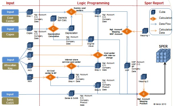

There is a picture about allocation design in my project, i think it coult help you.
allcation design.jpg (67.13 KiB) Viewed 5418 times
