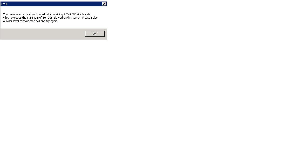

When I try to trace feeders from a consolidated element, I get the attached below message. What does this mean ..? Any change in the design need to be done.

Can't tell if a change to design needed but you do need to learn what you're doing. Simple solution = you need to trace feeders from a much less consolidated cell in the cube. If you want to know why read the explanation below.
Feeders act only at LEAF level. When you trace feeders from a consolidated cell your client session will loop through all leaf cells under the consolidation where a rule is applied and checks if the calculation is fed. All non-fed leaf rule cells are then displayed with a comment of "not fed" in the trace feeders window. This process can't use sparse consolidation but must check all leaf cells (think about what it's doing and you should figure out why) so consequently if a consolidation with billions of underlying leaf cells is selected then it will be slow. The error message you have posted is for your own protection as there is a (configurable in tm1s.cfg) threshold which the server checks and if the number of leaf cells is more then this then it stops. Otherwise you might be waiting for hours.
