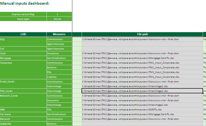

Post by nlashin »
Please, could you explain how to convert a value in the link and go to Excel. The screenshot below:
Re: Start local Excel file from tm1
=Hyperlink(link,Name)
From memory though putting a hyperlink formula inside an active form can produce sketchy results depending what version of TM1 you are on.
