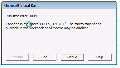

When I use it in VBA, it pops up with following error:
2015-02-18 09_22_09-Laptop - Remote Desktop Connection Manager v2.2.png (6.79 KiB) Viewed 4349 times

Those are very much "use at own risk", as I'm sure you're aware. But that having been said I'm able to run that macro with a 10.2.2 32 bit add-in in 32 bit Excel.
Are you perchance using the 64 bit add-in instead? Because I'd bet that that sucker was have been rewritten from the ground up and it'll be unsurprising if a lot of undocumented (legacy) functionality will have vanished from it.

Thanks, Alan. That is resolved by reinstalling excel. Reinstalling TM1 doesn't help.

Error message suggests excel can't reference the library containing the CUBES_BROWSE function. Unlike the public methods contained in the addin like tm1p.TM1RPTShowFormatArea or tm1p.TM1RebuildCurrentSheet, I think excel occasionally loses the object handle in memory.
I don't have 64 bit excel, but my guess is the addin(s) will still have the same function calls to xll and dll conditionally compiled for win32 or win64 architecture.
