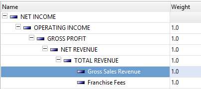

I have one Dimension (hierarchy) with some Members, for Example "Total Revenue" with two childs "Gross Sales Revenue" and "Franchise Fees". Both have weights "1.0" . (
Bildschirmfoto 2015-01-28 um 10.09.21.png (14.31 KiB) Viewed 1871 times

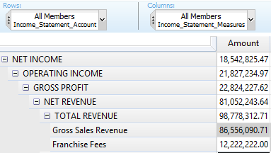

Now I want to link the Data for "Franchise Fees" from another Cube. The linking Rule works, but the calculation in for "Total Revenue" doesn't work. It seems, that this field doesn't know, that I linked some Data to the member "Franchise Fee" :(
Bildschirmfoto 2015-01-28 um 10.11.37.png (16.76 KiB) Viewed 1871 times
I tried the Buttons to "Refresh", "Automatic Recalculate" and "Auto Resize Grid" , but it doesn't work at all.
Do I need a special property? Where is my mistake?
