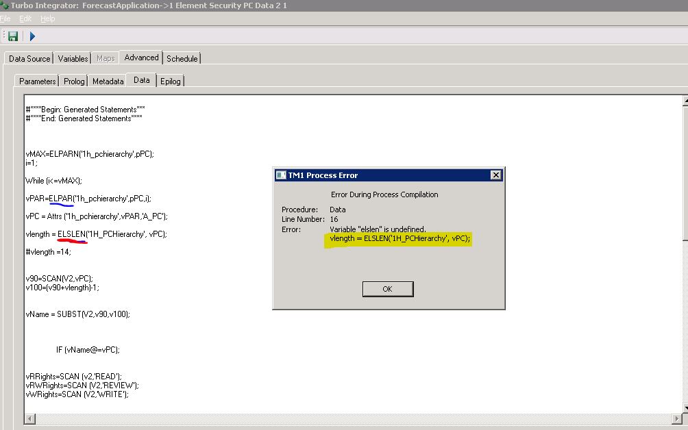

I want to find the length of the string so that i utilized ELSLEN function in my TI. Unfortunately, it is not working. I have attached the copy of error message along with my TI code for your reference. I utilized ELPAR and it works.
Could you throw some light on this issue? Is there any other way to find out the length of the string?

IBM Doc for ELSLEN wrote: ELSLEN
This is a CXL worksheet function, valid only in worksheets.

I think Long is the function you should be looking at. :)
