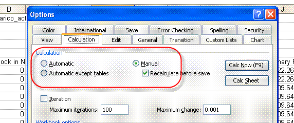

I am facing this issue whenever I take a snapshot / slice through Perspectives. The "Automatic" calculation option in Excel gets de-activated and the "Manual" option gets activated as shown in the attached screenshot.
- Automatic Calculation in Excel
- Automatic Calculation in Excel.GIF (18.72 KiB) Viewed 34956 times
I have to manually activate the "Automatic" option again ; needs to be done everytime a snapshot is taken.
Is there any option to prevent the de-activation of the "Automatic" option.

I don't think there is a way to stop this from happening, but it's bad practive to work with TM1 sheets and have calcualtion on automatic. If you do then everytime there is a small change in the excel environment all your TM1 sheets will get recacluated. This just grinds the server and creates network traffic where none is required.

This can be managed using VBA in the activate / deactivate macros of excel workbooks.
'automatic calcualtion
Application.Calculation=xlAutomatic
'manual calculation
Application.Calculation=xlManual
but this is pretty cumbersome and can be quite a maintenace burden depending on how many spreadsheets you have. Not really a solution more of a workaround.
If you add the automatic one to the workbook activate event then you can at least ensure that the pure excel workbooks behave normally.
