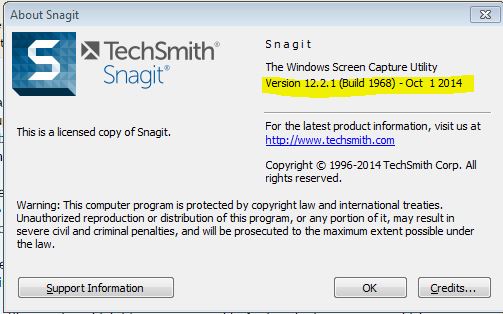

On the client side I'd think that the main user case is that every software company and its dog puts an About -> Version entry in its client software for an obvious reason; "what version are you on?" is the number 2 support question after "what program are you using?". If you have 150 users using a piece of client software and you find that some of them are having problems that should have been sorted in a patch, you don't want to have to go to their workstations and start digging through their hard drives when the (faster, quicker, cleaner) option is to ask them to just go to the Help menu and select About.
Unfortunately IBM tends to take the view that this should be unnecessary because everyone deploys the latest version the instant it becomes available. This theory does not necessarily coincide well with real life practice, and it's not uncommon for multiple client versions to still be hanging around on different machines across the business. Being able to quickly and easily identify exactly which version (including FP, HF etc) that a user is on is of pretty significant value in a real life deployment.
If it can be automated so that it can be grabbed via code (say via a worksheet function) so much the better, as it would be possible to then simply have users open a workbook which will "phone home" the relevant information making life far easier for the administrators.
If it's in a 50 buck screen grab program like Snagit, I think it's not unreasonable for it to be in a program which costs as much as TM1 does.
