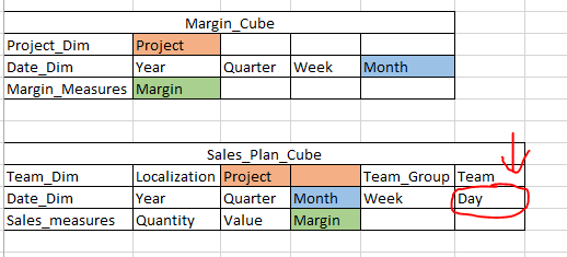

I have following cubes as attached.
Cubes
Cubes
I've written a rule in Sales_Plan_Cube to set Margin value based on Project margin value for the same month on a leaf level but it doesn't work as expected.
['Margin']=DB('Margin_Cube', !Team_Dim, !Date_Dim, 'Margin');
It assigns margin value from Margin_Cube to consolidated (Project, Month) in Sales_Plan_Cube instead of Leaf members (Day and Team).
Result
Result
How should I correct my rule?

Is Date_Dim the same in both cubes or do you have separate dimensions? Is one with a n-level of month and one with a n-level of date? Or, are you storing margin % at a consolidated level in Margin_Cube using string elements, or other calculations? It makes something of a difference to the answer.

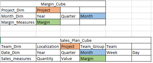

Date_DIM is not the same, I've changed the schema.
!EDIT
Correct Structure
Correct Structure
So the rule placed in Sales_Plan_Cube still looks the same, but Margin_Cube Dimension name changed to Month_DIM.
I still use the Date_Dim as it finds matching member by name.
Margin measure in Margin_measures and Sales_measures is numeric value.

Your two date dimensions are different in that weeks and days don't exist in your source cube. So you need a way to map the days and weeks from date_dim to the elements in month_dim from which they should source their data (I'm assuming it's the months). One very classical way would be to add a text attribute to date_dim and populate it with the appropriate month_dim element names. Then instead of referencing !date_dim in your rule you use ATTRS to get the element you need. You also need to think what happens for years, querters etc. (i.e. if you need to populate the attribute for these and with what) - your rule is unqualified, so you need to think how it will behave on any level of aggregation.
Feeding this should be quite straightforward, I don't see the need to have an attribute to reverse the month-week-day mapping.
