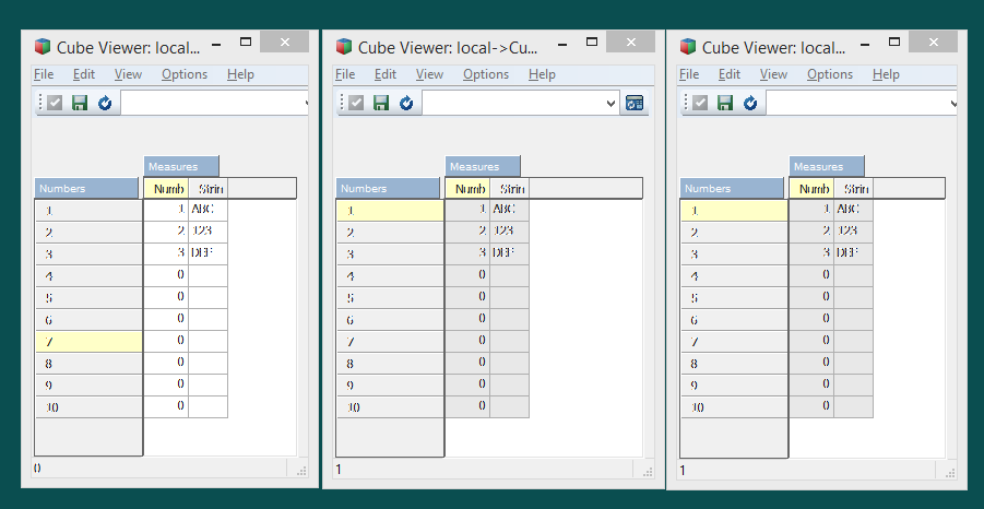

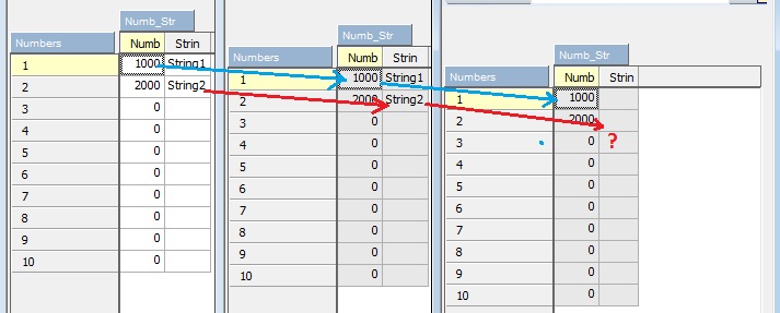

4. Input numbers and strings in Numb_str Cube
The result of calculation you could see next (at left Cube Numb_str, at the middle - Numb_str1, at right - Numb_str2) :
So that is the problem with string rule? What I have to do to put String in the third cube?

I only want to show numbers and strings (example is simple - in real life - task is more complicated of course) and I don't need to feed.
And also I don't want to calculate.
And it seems for strings - Tm1 allows that there is no string data in Numb_str1 - but why?

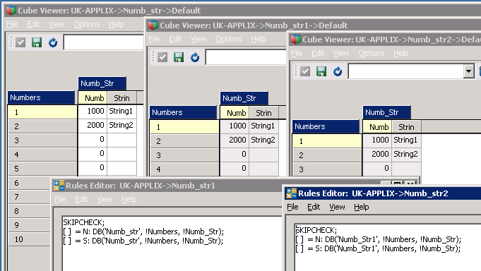

You're right, Lotsa. I just built this in TM1 10.2.2 FP1 (10.2.20100.123), and it works as intended. I think this one can be chalked up to a bug in EP_explorer's version (10.1.1 based on profile). At the risk of being accused of being an IBM support sleeper agent: upgrade to latest version.

Well, you got my curiosity up, so I checked it out on my version (10.2.2) and it seems to work fine.

I just checked my copy of 10.1.1 fp2 and it seems to work fine there too.

lotsaram wrote: 2/ Limit the area to only the relevant N or S area
Numb_Str1
['Numb']  = N: DB('Numb_str', !Numbers, !Numb_Str);
['Strin']  = S: DB('Numb_str', !Numbers, !Numb_Str);
IMO this is the correct approach although it's going to be a problem in a moving dimension where you aren't sure what new string elements have been added. I've seen a problem where there seems to be confusion in the results where S: rules at the leaf level of the cube not calculating when there was an N: rule applying to the same intersection. It's probably always worth it to try to be specific as possible on the left-hand side of the rule.

You know
SKIPCHECK;
['Numb' ]  = N: DB('Numb_Str1', !Numbers, !Numb_Str);
['Strin' ]  = S: DB('Numb_Str1', !Numbers, !Numb_Str);
works
Also I check in 10.2.1 and
SKIPCHECK;
[ ]  = N: DB('Numb_str1', !Numbers, !Numb_st);
[ ] = S: DB('Numb_str1', !Numbers, !Numb_st);
works as well
