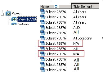

when I check in the random view, The subsets for ABCD and XYZ are not created.

I am not getting any error message, Process successfully executed but it's not doing data export.
When I check the view it has generated, the two subsets for Dim's ( ABCD , XYZ) I am creating using MDX doesn't have any values in it. whereas I can see other subsets of dim's are populating with values.

Looks like it's looping and creating subsets in the dim's but not loading values in the two subsets using MDX.

I have tried that, but I can see the empty subset.

Re: Data export TI process doesn't work in TM1 10.2.2
If you open the created subset in the subset editor is the MDX expression in there?

Hi Declanr,
I can't see the MDX expression in subset window.

But there is a work around, Instead of running a loop, when I try to create each and every dimension and subset manually, it works fine.
I am wondering it's the same code working fine in cognos express but not in TM1 10.2.2.
