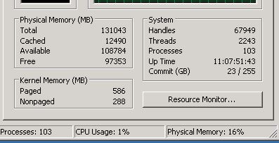

Jim
Could it be the reason?
[img]
[/img]
Thank You
Dharav Patel
Re: TI of Data Upload
Same version of TM1 on both? Same entries in the TM1s.cfg file?
What happens in the TI process, for example, Data Source is a flat file on a location that one server cannot easily go to?
Did you time Prolog / Metadata / Data / Epilog, breaking down total run time of the process?
If you reduce the size of the data source, do you see the same kind of effect or not ?
And so on. Try to break down the problem in smaller bits to see what's going on.

First of All , Thank You all for valuable inputs.
1) I turn off the PersistantFeeders in cfg file to F
2) Re write the feeder. It was overfeeding so it was consuming memory and process was taking time to upload.
once i modified and re start, now it's taking 13 gb instead of 79 gb. Process runs in few seconds.
