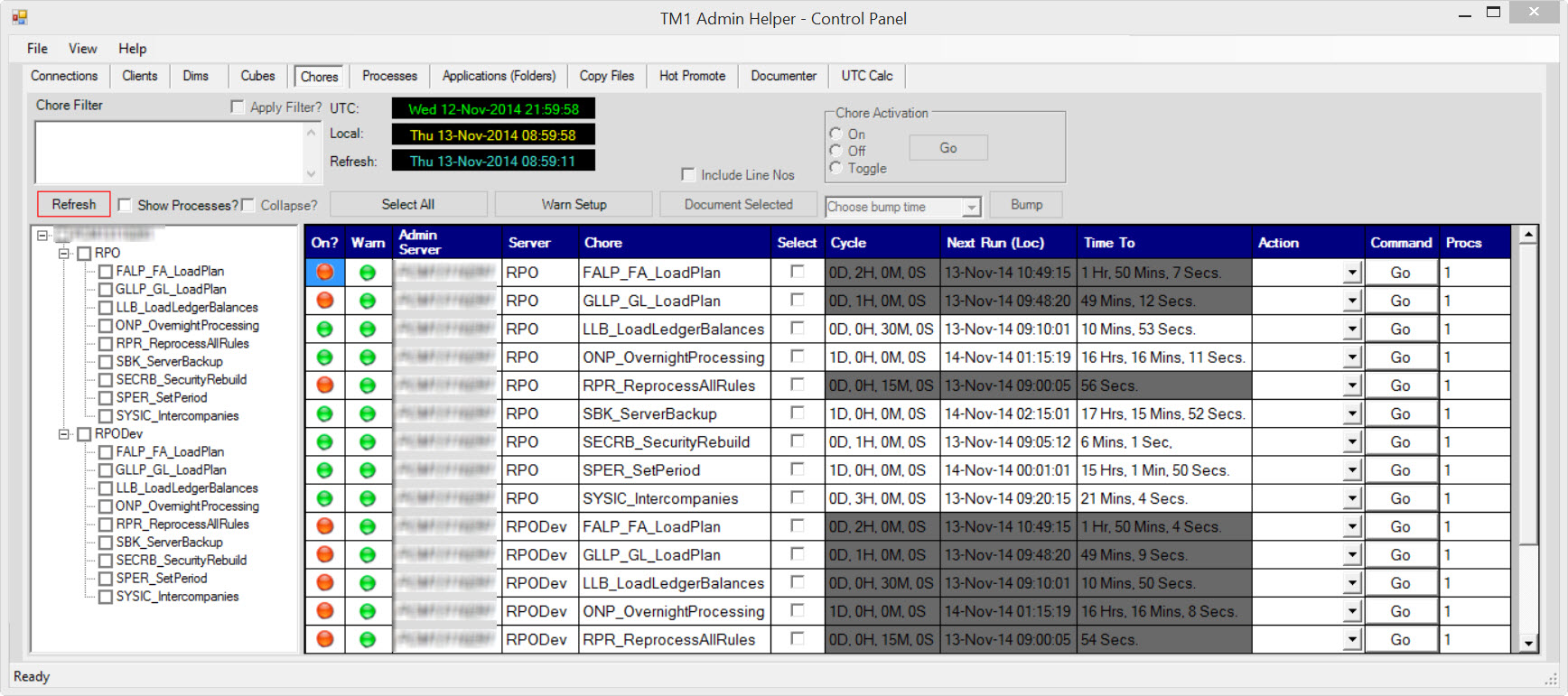

Re: Daylight Savings Time - 10.2.2
Sorry, I hit a non-TM1 busy patch just recently and missed the later replies in this thread until I saw another one come in this morning.
mattgoff wrote: But I guess they were too busy making the v10 icons even less distinguishable than they were in v9. It is nearly impossible to see if a chore is enabled or not at a glance,
Damn straight. At that point the temptation to DIY sometimes becomes overwhelming. The following would never pass muster at IBM where the icons must be corporate themed, and the designers wouldn't know the expression "UX" if they were clubbed over the head with it:
If it wasn't occasionally true it wouldn't be funny. But if it was always true it wouldn't be funny either, just for a different reason. If it's approached from the point of view that "I have this one task, let's see if I can knock up an API based program for it" then yes, it may well look like that. (Though in reality the "Ongoing Development" phase of the chart could more honestly be labelled "playtime".) As you can probably guess from the above, that's not the approach that I took. I wrote an application which has some core API-related functionality. The functions were kept as generic as possible. I need a property of an object? That code's already there. I need to iterate a collection of objects? Same thing. Then I just build extra bits and pieces onto that as and when I need to. It skips a lot of the development time because the base code has already been developed, and unlike a certain 4 letter language starting with "J" the front end is ridiculously easy to build and hook the back end code to. Which also means that I get to where I want to be faster. Which also makes the rethinking phase less of a burden because I had long since thought out all of the things that I want this thing to do. Which also means that there is less temptation to spend time on the "ongoing development" phase. Once I get something working for a specific purpose then there is still other stuff to do.
And with a 4 hour commute every day, it's not like I'm short of time to do it, if I don't have other more important things to do. Which is not as often as I'd like.
Which is why:
jcr55 wrote:Alan Kirk:
.."Write your own API-based tool to do the bouncing. "
We also have to manually update our chores each spring and fall. Currently on 9.5.2.
Is there any way you could share that chore start time updating tool?
I'm afraid that I must decline. If this was just a module of code in a VBA workbook I might be OK to do that but I'm afraid that this goes way beyond that because I've put a LOT of work into this thing (on and off admittedly, and also as a combination of .Net learning and playtime also admittedly, but a lot of work nonetheless) over the last couple of years, to the extent that it falls into what I said here about sometimes exceeding the "crossing of palms with silver" point of development. Except that it's currently in no condition to sell either (as I said I just add in functionality as I need it) and may never be, since I have many fish and a very limited number of frypans. Still, I'm glad to see that Robin has given you a decent workaround; you do need to take the server down to use it but if you have a lot of chores it's probably worth it.
