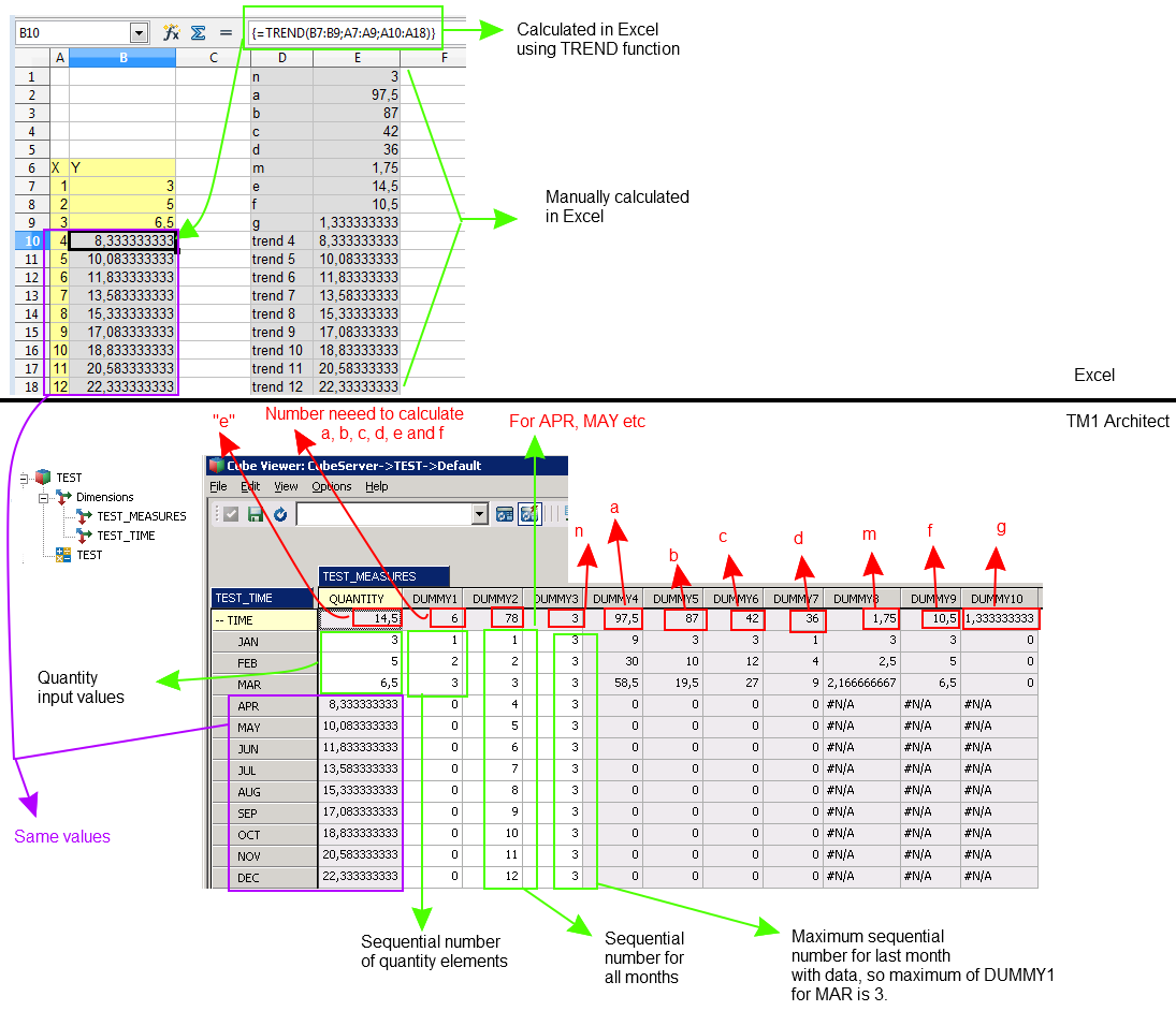

I have the following data (simplified sample):
- Time: JAN; Quantity: 3
- Time: FEB; Quantity: 5
- Time: MAR; Quantity: 6.5
Now I have a task to calculate 'linear trend' for months APR to DEC.
How to mathematically calculate trend I have found web page: http://classroom.synonym.com/calculate- ... -2709.html
According to above web page (my sample is exactly the same as above web page suggests) I have created 10 dummy measures and wrote rules. See bellow image and rules.
TM1 model works fine, correct values, but just wondering is there some other simpler way to create a linear trend line?
My system: Cognos TM1 Architect accessing Cognos TM1 10.1.1 fixpack 2 on Windows server.
