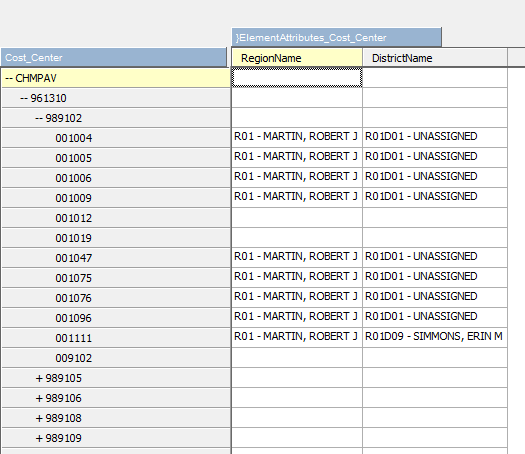

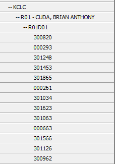

Cost Center Hierarchy to be as below
RegionName(Attrs of LeafLevel)->DistrictName(Attrs of LeafLevel)->Leaf Level CostCenters
For example , Please check the below screenshots... leaf elements have the RegionName and District Name Attr Names. if Elements have different Attribute names under Hierarchy , we need to consider the common attribute name which max elements have. in the below examplen it should be R01-MARTIN,ROBERTJ -> R01D01-UNASSIGNED->ALL LEAF ELEMENTS UNDER THAT.
Any help in logic is much appreciated.
After Hierarchy it should look like this
Before Hierarchy it looks like this

Hi Sam,
Are you looking for Hierarchy creation based on all elements listed.
Or you need only the one which have max elements?
You need leaf level elements to be under the consolidated element "RegionName(Attrs of LeafLevel)->DistrictName(Attrs of LeafLevel)" separately or all under the one which have maximum elements?
