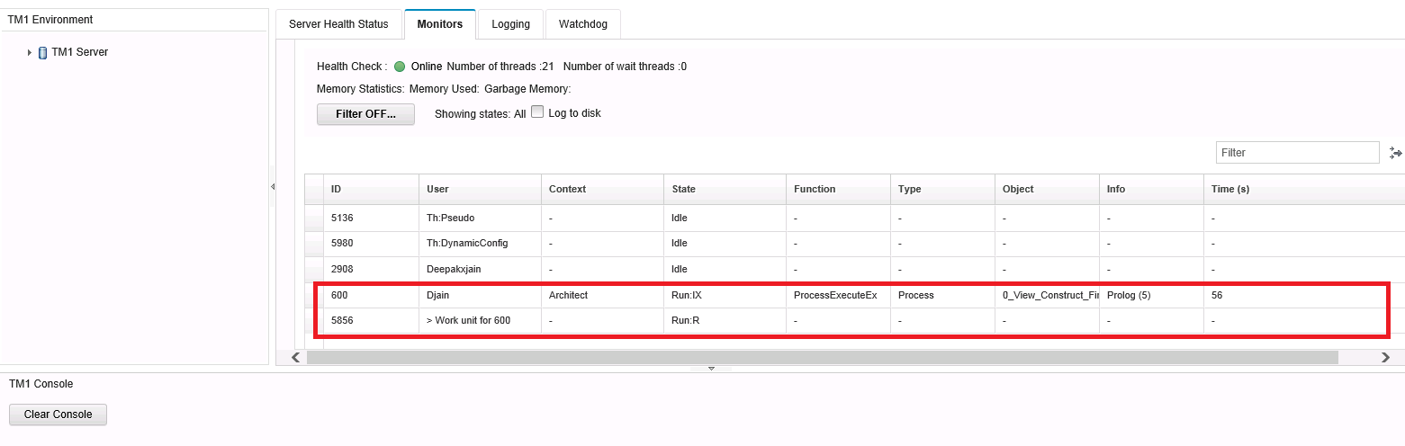

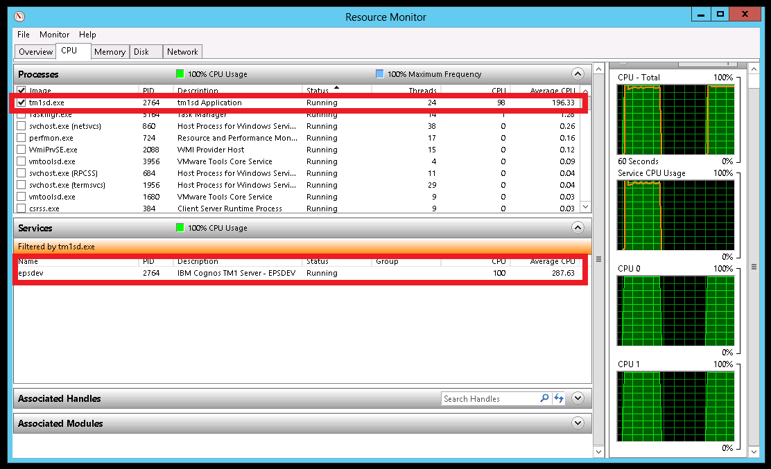

I was trying to enable MTQ functionality. We are having two virtual processors so added MTQ=2 in tm1s.cfg file.
OpsConsole shows it is working as per below screenshot

Resource Monitor shows CPU Usage of 100%, seems to be positive
CPU Usage.png (38.15 KiB) Viewed 4056 times
But the server crashes after few minutes.

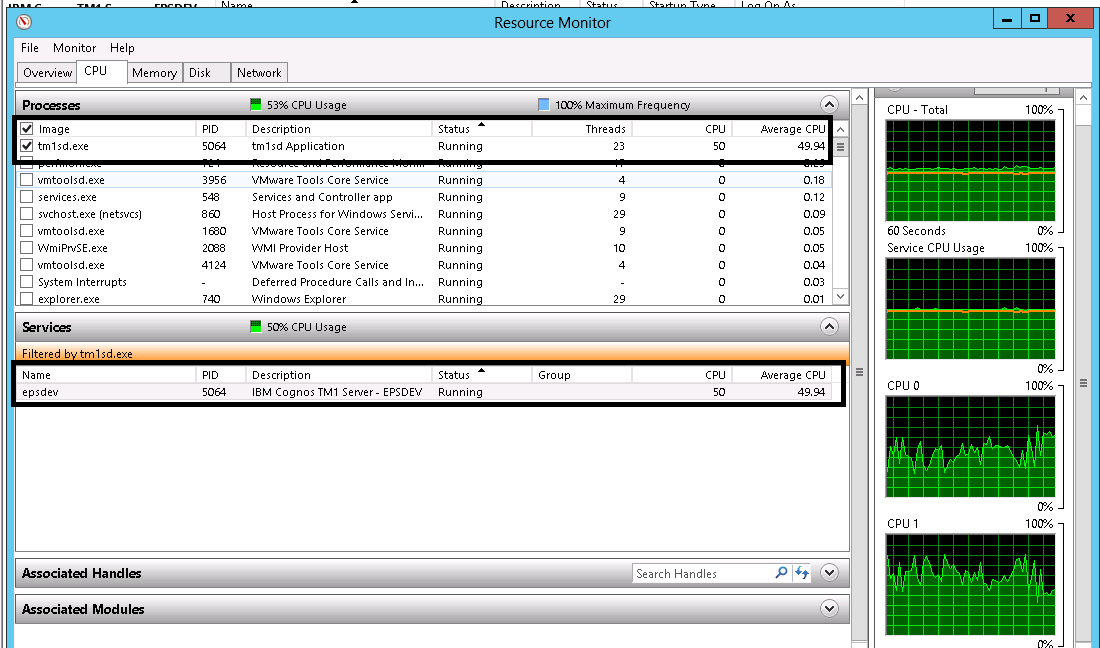

If we set MTQ=1, we have only one core working as per screenshots below
CPU USage MTQ =1.png (34.85 KiB) Viewed 4056 times

If I see the ops console with MTQ = 1, it doesn't have "> Work Unit for 600". Where 600 represents the ID, it can vary based on the process triggered.
The server is crashing because it is using all the cores available?

To the issue I shared, it is always good not to use all the cores available.
We have increased cores from 2 to 4 and now when we had MTQ = 2 in tm1s.cfg file it is working perfectly fine.
Will be sharing if any other information I get in future why it was crashing when we are utilizing all the cores available.

Always leave at least 1 (or a few more) cores available for background processes and other users & applications. Otherwise MTQ could completely stall the system on a big query.
Also be wary of the TM1 version. MTQ seems pretty stable in 10.2.2 but from my experience testing 10.2.1 MTQ was gauranteed to cause a server crash if anything else was triggered at the same time as a view was running with MTQ.
