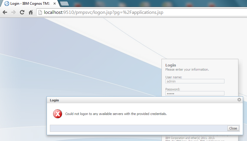

Hi There,
I was working for quite some time by TM1 application URL "http://localhost:9510/pmpsvc/" and able to log on and create application(s) and then connect to performance modeler and Insight.
Suddenly, It's throwing an error Could not logon to any available servers with the provided credentials. while logging in.
I gave a try by ...
Deleting csk, encryptkeypair, signkeypair folders and restarted the server, but it still gives me the same error.
I have checked fpmsvc_config.xml under C:\Program Files\IBM\cognos\tm1_64\webapps\pmpsvc\WEB-INF\configuration. Both the server names in tm1s.cfg and fpmsvc_config.xml are same.
FYI, I have not changed any credentials.
I request you, if any one have encountered the same issue and got resolved.

- Could not login to any available servers with the provided credentials.png (105.99 KiB) Viewed 17583 times
Thank you,
syd

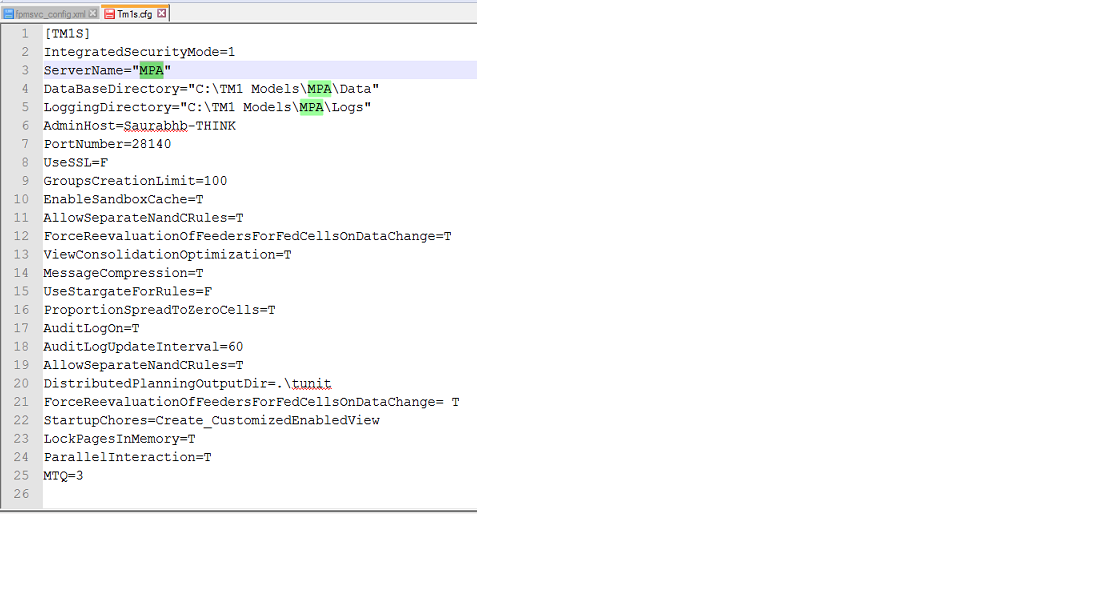

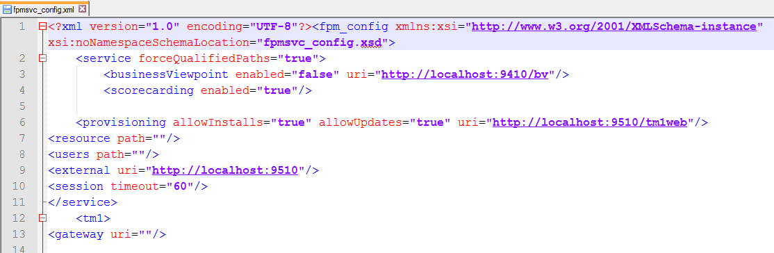

What type of security are you using?
Can you provide a screenshot of fpmsvc_config.xml and apps server config please?

Re: Could not logon to any available servers
Please find the configuration files attached...
- config.png (97.76 KiB) Viewed 17257 times
- fpmpsvc_config.xml.png (25.95 KiB) Viewed 17257 times
Thank you,
syd

EvgenyT
- Posts: 324
- Version: PAL 2.0.8
Add:
-<tm1>
<gateway uri=""/>
-<alternate_gateway_uris>
<alternate_gateway uri="*"/>
</alternate_gateway_uris>
-<admin_host name="machine_name">
-<servers>
<server name="MPA"/>
</servers>
</admin_host>
</tm1>
-<tm1>
<gateway uri=""/>
-<servers>
</servers>
</admin_host>
</tm1>
I have updated accordingly and working well.
Thanks for your support and time.
