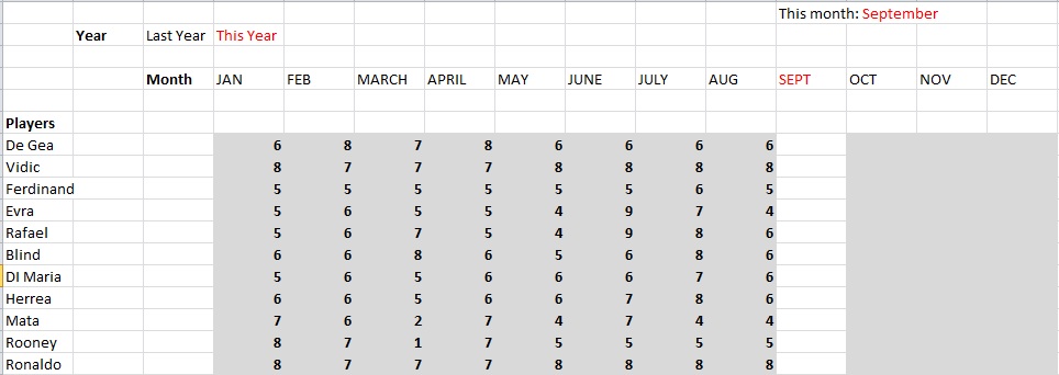

After reading some of the feedbacks, I came up with an idea to show what I am trying to do. Obviously, because of confidentality, I have designed something on football.
The image below will show that I have players and I have monthly ratings on how those players did those months.
Now because 'sept' has matched this month: September, they will be white cells so I can rate these players again, but as you can see, the other months are grey cells.
That is what I want to achieve... Now if this month: was an attribute, how would I do this using that attribute.
Originally I was trying to do if I am not this month: then grey me out.
Does this make more sense now? :)

there are a number of ways to approach this, but first we need to identify exactly what you mean by Grey it out.
I'm going suggest that you want to allow input when the Month = This Month and not when it isn't.

Re: IF I AM NOT attrs
Neil Watson wrote:Possible 1
Create another cube which will hold the Ratings data and is fully open to input.
In your cube below, have a rule similar to
['Rating'] = N:
if (!Month @= attrs('Month', !Month, 'This Month'),
stet,
DB('Ratings Source', !Month, !Year, 'Rating')
Possible 2
Create a new element in the Measures dimension one called "Input" and the other called "Reporting",
"Input"
"Reporting"
['Reporting'] = N:
stet,
['Input']
Possible 3
You create security rules on the cube and a rule similar to,
[] = S:
if (DB('}ElementSecurity_Month, !Month, !Groups) @= attrs('Month', 'This Month'),
'WRITE',
'READ'
While Options 1 and 2 will work, they are less then optimal because it will be impossible to have a cube view that looks like what the OP has shown. You would have to do it in a web sheet. Option 3 is the best way to go and it's really quite simple.
