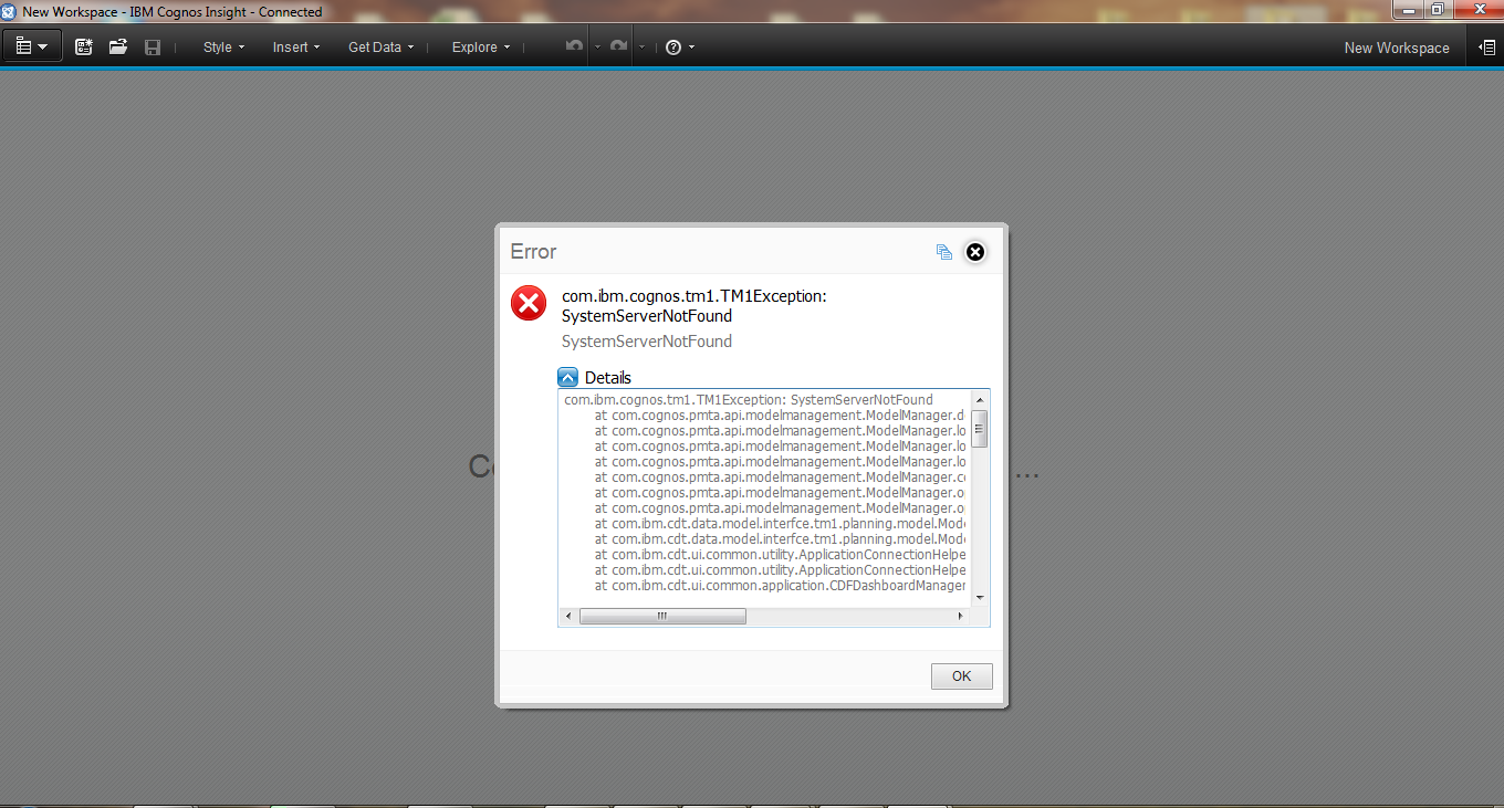

I have a TM1 module (version 10.2.1) and try to connect using cognos insight 10.2.2 at client pc.
however it state system server not found.
I remote into the server use cognos insight to connect the tm1, it success.
However, i have closed all the firewall and added IPVersion=dual,IPAddress=127.0.0.1 into the tm1s.cfg file
still no luck.
please let me know if anythings I haven't try out ...
Thanks in advance,

Cognos Insight - Connected
- cognos insight error.png (124.33 KiB) Viewed 5051 times

Re: Cognos Insight - Connected
furthermore, performance modeler also unable to connect to the planning server.
