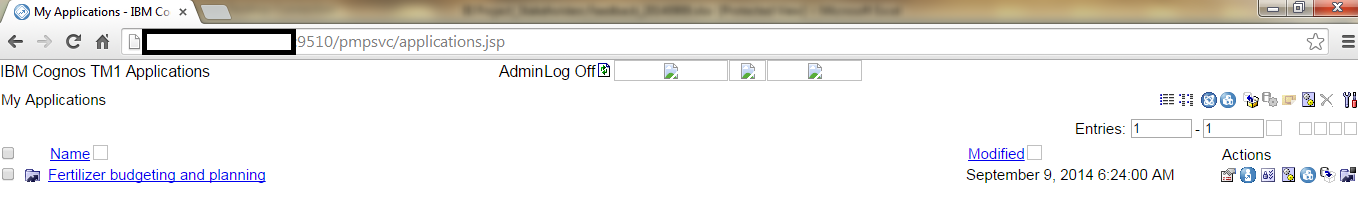

I have set up a TM1 server and build an application.
the application view using localhost, it is fine.
however use the computer name to access. it become different layout.
application layout.png (65.46 KiB) Viewed 2364 times
Please shed some light on it.

i have found the solution.
The localhost is pointed to different DNS suffix name which is different with the server name.
I have changed the hostfile to make the name same as server name and reset application setting using the server name instead of localhost.
