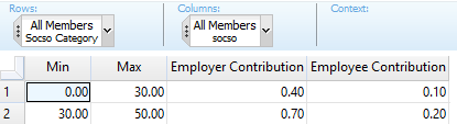

1.socso
2.overhead

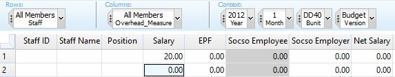

I need to lookup the salary I key in the overhead cube and get a contribution.
Overhead input view:
socso:
I used the following logic formula.
['Socso Employee'] =N:if( (['Salary']<=DB('socso','1','Max')) ,DB('socso','Employee Contribution'),CONTINUE);
However when i key in 20, it return 0.
wondering any part that i missed?

You miss the element '1' in your True part:
Every cube has at least 2 dimensions.
