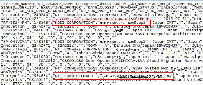

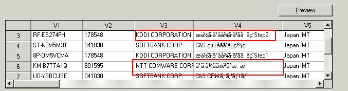

I have a text file which contains some Japanese characters. When I open the text in my local I am able to view those characters. But when I preview the same in TM1 its not displaying properly. I think they appear as ASCII encoded. Is there any way to make them appear as it is ? Any TM1 setting need to be changed ?
Attaching the Actual file view and TM1 view for your reference.

What happens when you execute the process and output the string to a text file?
You can also have a look at the following TI command: SetInputCharacterSet
http://pic.dhe.ibm.com/infocenter/ctm1/ ... erset.html
The value you need is probably TM1CS_WCP932.

Where should I give this code ? Under Prolog tab ?

Yes,Prolog tab.Thanks
