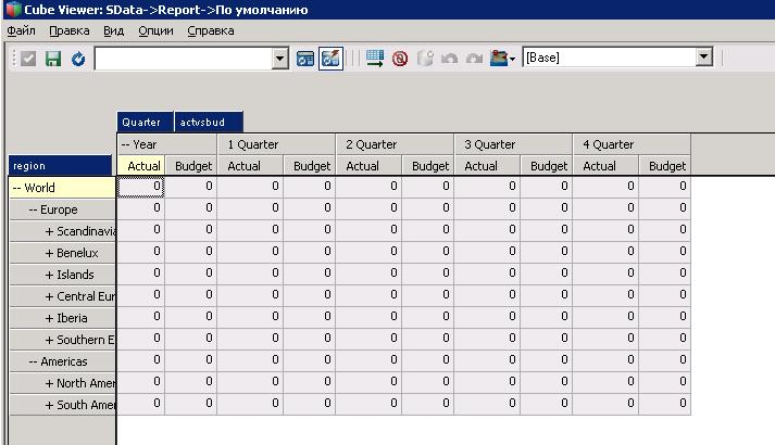

I create a cube in Sdata server and a view based on the cube
I want to hide element Actual in Year element but show it in Quarters elements

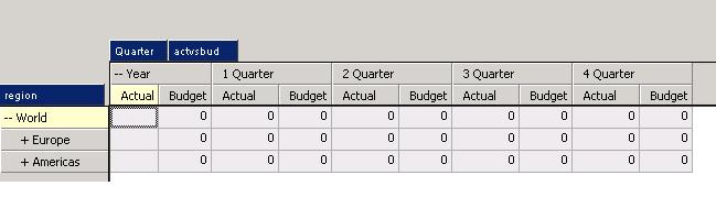

What i tried to do - created cellsecurity cube for Report cube and add rule which put
None in cells for Actual and Year. Anyway it shows what I want to hide although values disappeared
Is possible to hide elements in the way that I want?
May be I could try something else - MDX or something else?

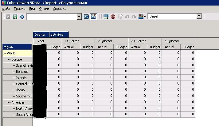

1. If I add zero supression it will supress everything but I don't want to supress everything.
2. I did it and result is unsatisfactory - see first message
3. I don't need to do it thourgh Excel
4. The question isn't not to calculate but not to show
It is only example. I don't want to show some measures (like Actual and Budget) elements with combination in long time hiearary.
The idea which come to mind - add dummy element in region hiearachy, add in elements (for combination time and measures) which I need - 1 and supress zero in columns. But I don't want to show for users this dummy element. It is a problem
