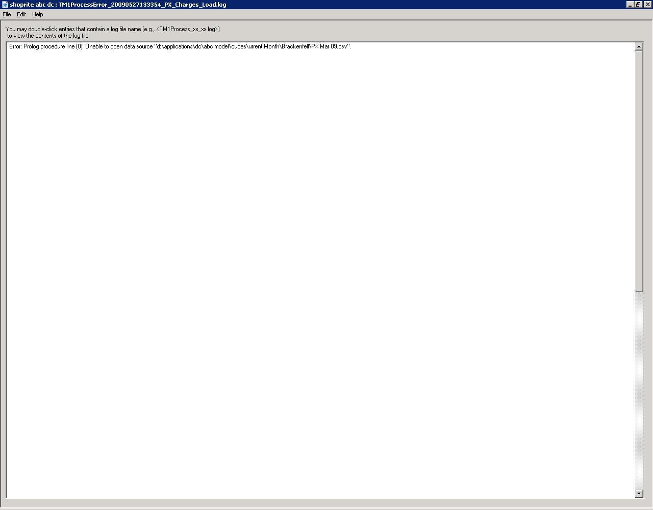

The path in my TI Data Source name is correct but when the file is loaded the error message in the attachment error occurs.
When the logfile is opened thie Error Message appears.
What is interesting is that in the Data source name in TI includes the "c" of current month. But the log file shows it without and hence the error message.
Any ideas on this one?

- Error Message.JPG (52.59 KiB) Viewed 3607 times
- Error.JPG (8.51 KiB) Viewed 3607 times

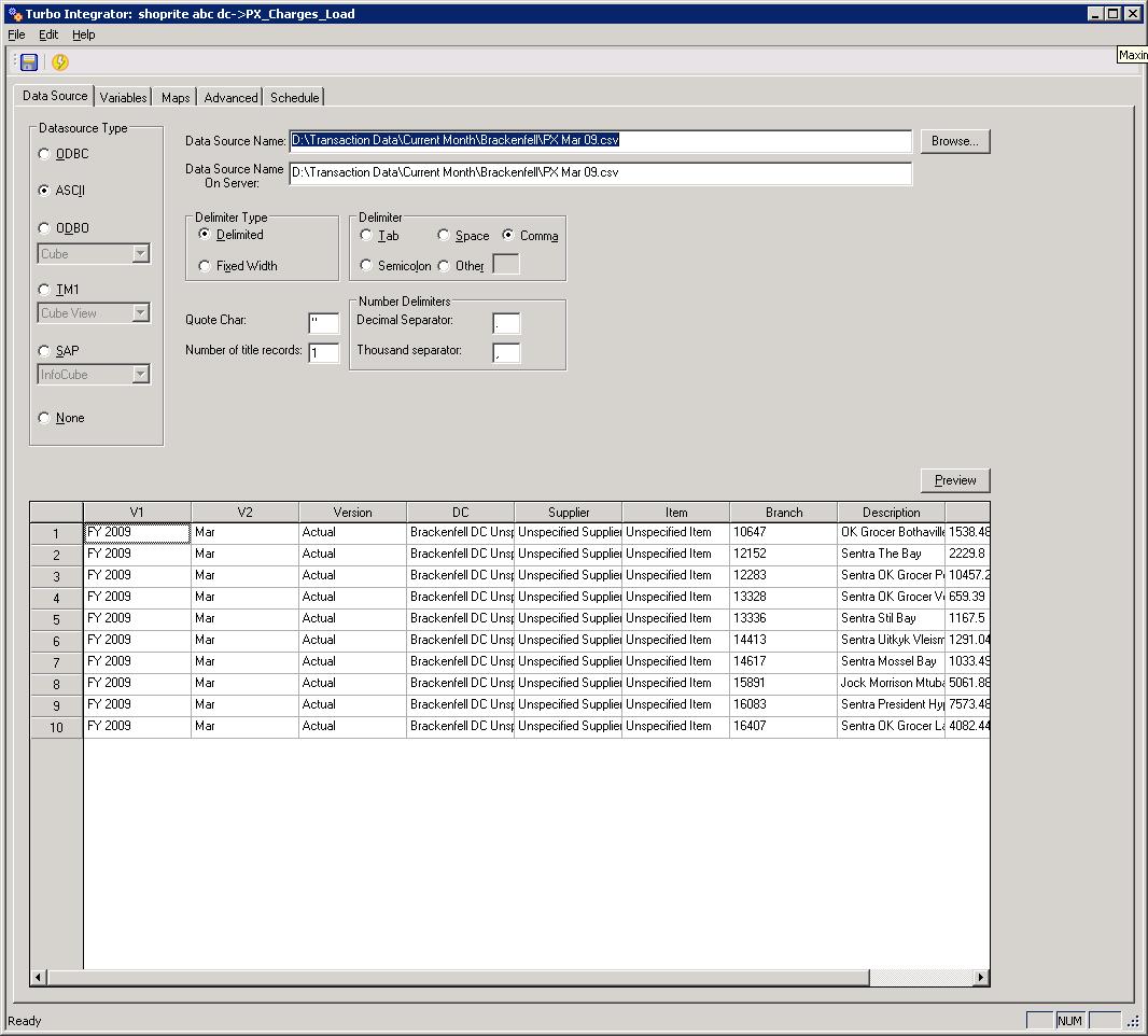

On the datasource tab you have two entries to specify the sourcepath (for client and for server). Could it be that you typed the client path correctly and the server path without the 'c'?

Jip names are the same. Here is a screenshot of the process.
Got any other ideas?
- TI screenshot.JPG (142.5 KiB) Viewed 3573 times

Is there also no code on the Prolog tab using DataSourceNameForServer to change the source path?
