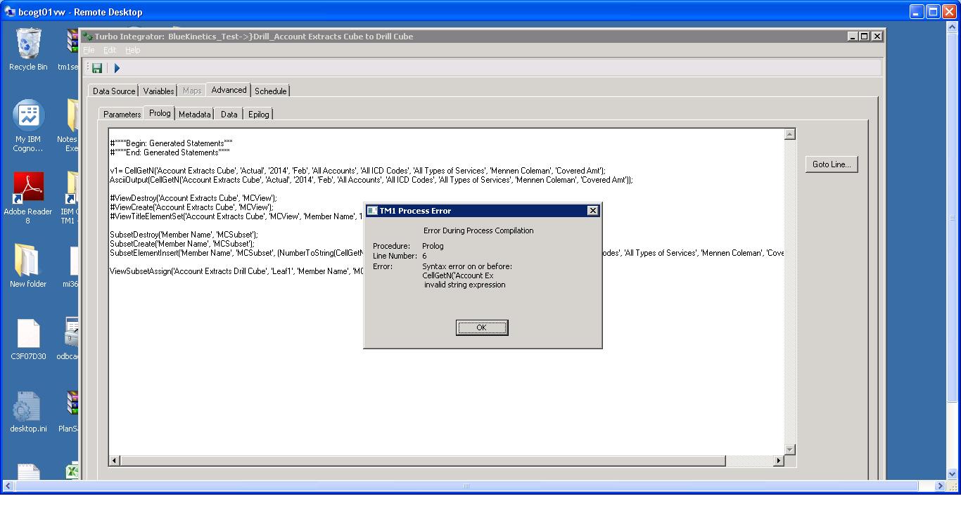

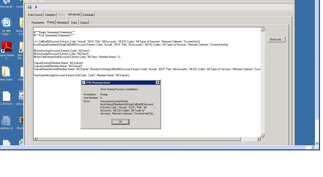

Wim, I had tried Asciioutput before as well and faced issues -
- When I try Asciioutput as suggested by you, it gives me error saying 'Unexpected Parenthesis'.
Unexpected Parenthesis Error
Unexpected Parenthesis.JPG (116.57 KiB) Viewed 11628 times
- If I remove NumberToString function, it throws error - 'Invalid String Expression'

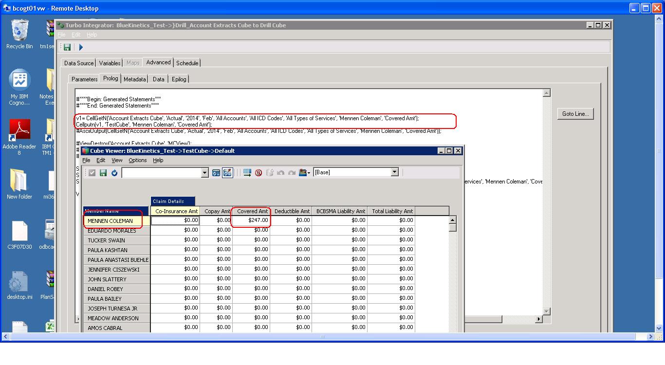

Hence, I tried adding this value to a test cube using CellPutN and the actual Covered Amount for the member is added correctly as shown below.
CellPutN
CellPutN

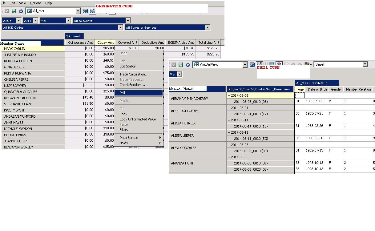

Decalnr, screenshot showing drill from origination cube to drill cube is as shown below -
Org cube to drill cube
Org Cube to Drill Cube.JPG (130.34 KiB) Viewed 11587 times
Tomok, i get my mistake. I was trying to pass an element from one dimension ($ amt) to another (member name); hence the element was not being added. As per your suggestion, I tried to pass the parameter value that represents the member name into the SubsetInsert function. So now for any member selected from the origination cube, the drill cube shows only the member that was passed through the subsetinsert function. How do I achieve the functionality of dynamically passing the selected member name to the drill cube so that only equivalent member's details are displayed?
