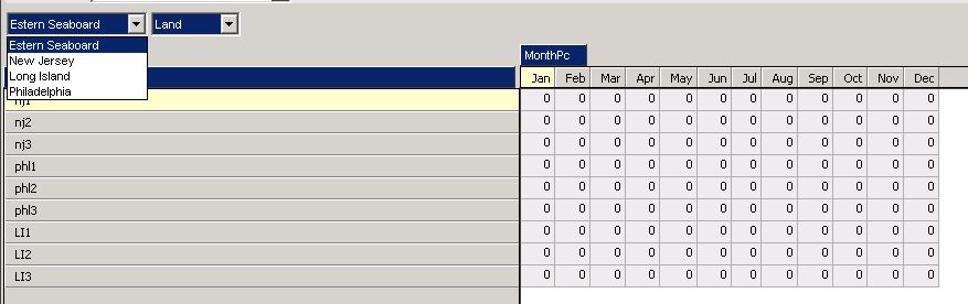

I want to know can we filter a subset subset on the basis of element selected in another subset.
I have a view where i have to establish following functionality:
Cube A
[img]
[/img]
Here, If some one select New Jersey from drop down than it should show only NJ1, NJ2,NJ3 only in the raw dimension.
Can we utilize MDX Statement , assign attributes to the elements and apply in to MDX statement? i am not familiar with MDX statements.
Thank you all once again for your Valuable Inputs and time spend on it. :) :) :)

Re: How to bring the total of elements in to other cube?
Posted: Tue Jul 01, 2014 5:08 pm
by dharav
BariAbdul wrote:This might help:
http://www.tm1forum.com/viewtopic.php?f=3&t=5933
Thank you for Input. I couldn't able to do it when there is consolidation element in the Relation subset. Anyidea about the consolidation element along with leaf (Level 0 element) element.
Dharav
Posted: Wed Jul 02, 2014 6:32 am
by BariAbdul
Thanks to Wim ,Pls go through below examples:
• Leaf-level descendants of a given member:
{TM1SORT( {TM1FILTERBYLEVEL({DESCENDANTS([FIN_Account].[EBIT]) }, 0)}, ASC)}
or:
{TM1SORT( {TM1FILTERBYLEVEL({TM1DRILLDOWNMEMBER({[FIN_Account].[EBIT]},ALL,RECURSIVE)}, 0)}, ASC)}
Leaving out the filter by level will return the consolidated element(s) as well. So, DESCENDANTS and TM1DRILLDOWNMEMBER both include the parent element that was drilled upon.
• Leaf-level descendants of 2 consolidated members:
{TM1FILTERBYLEVEL( { UNION ({ DESCENDANTS( [FIN_Account].[EBIT] ) }, { DESCENDANTS( [FIN_Account].[Taxes] ) } ) }, 0)}
• Leaf-level descendants of a given consolidated member, that consolidation included:
{UNION( {FIN_Account.[EBIT]}, {TM1FILTERBYLEVEL({DESCENDANTS(FIN_Account.[EBIT]) }, 0)} )}
or:
{FIN_Account.[EBIT], {TM1FILTERBYLEVEL({DESCENDANTS(FIN_Account.[EBIT]) }, 0)} }
Note: The Union function can be shortened to the + operator (an element is listed only once):
{FIN_Account.[EBIT]} + {TM1FILTERBYLEVEL({DESCENDANTS(FIN_Account.[EBIT]) }, 0)}
or, now EBIT is at the bottom of the list, the order of the elements in the expression is retained left to right:
{{TM1FILTERBYLEVEL({DESCENDANTS(FIN_Account.[EBIT]) }, 0)}, FIN_Account.[EBIT] }
Posted: Wed Jul 16, 2014 6:21 pm
by dharav
Hello All/ BariAbdul
Thanks for your time and inputs.
I got the solution of it. I did following step
There are 2 dimension 1-> Source Selection dim 2-> Target Change Dim
1) Created attributes in both dimension for the same elements but different level.
Dim1
California (Level1)
Las Vegas (Level 0)
San Jose (Level 0)
San Fransisco (Level 0)
Dim2
California (Level 2)
Las Vegas (Level 1)
A
B
C
San Jose (Level 1)
D
E
F
San Fransisco (Level 1)
G
H
I
2) Now in dimension 2 - apply mdx statement with filter where you can get the values by equating two dimension with their attributes.
3) Modify the above mdx statement with TM1DRilldownMember.
4) !Bing0 -> Required result is obtained.
