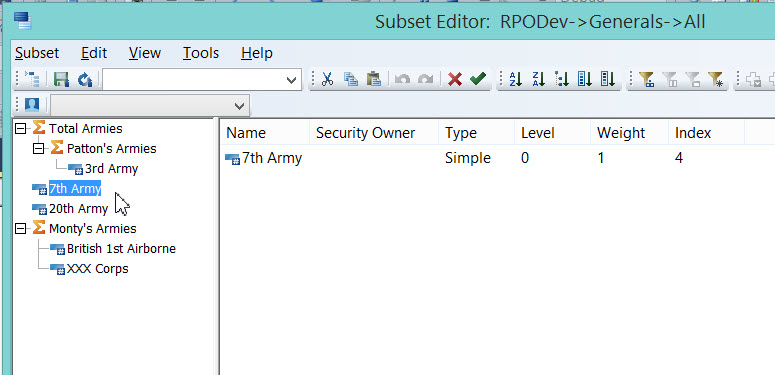

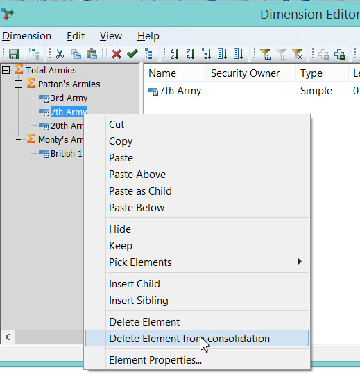

Most likely the documentation, unless it's a version-specific thing. I can't reproduce it either in 10.1. I had a test hierarchy that I had created through some API tests. Let's leave aside the fact that the buggy piece of ... software... that is Dimension Editor wasn't showing the last element in the dimension and concentrate on deleting the one named 7th Army. This is the whole dimension, "show all elements" and all. The dimension had been created entirely by the API and was otherwise untouched at the time. The element therefore appears in one place only, at the hierarchy point shown:
The result? It's bounced out of the hierarchy but remains as an orphaned N element in the dimension. (If you sort by hierarchy 20th Army appears under 3rd with 7th at the bottom, outside the total):
The statement makes no sense anyway. An element can never be defined "only within the consolidation". It always exists in its own right as an N, S or C element, and may be merely attached to one or more consolidations. I thought that perhaps they meant that if you added a new element as a consolidation's child and then removed it before saving the dimension, you'd lose it entirely... but even that didn't work. I did that and when I went to look in Subset Editor lo and behold there was the new N element, just without any parents.
